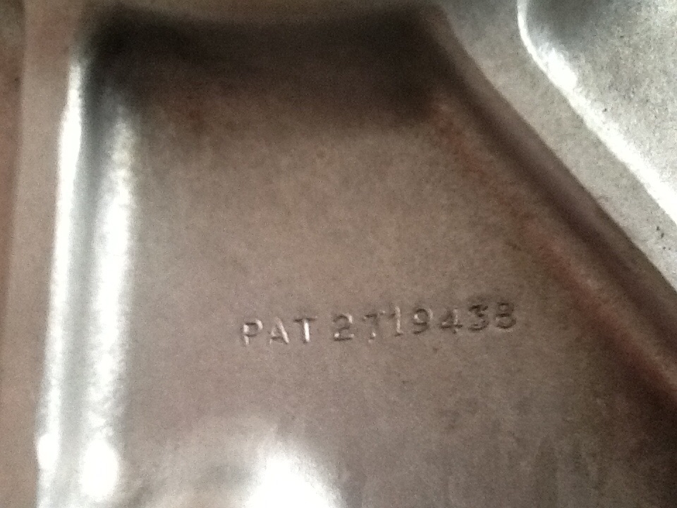

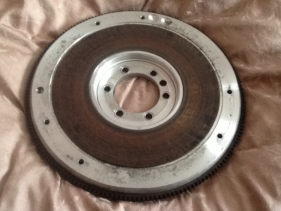

    Ok, question for those wiser than myself. I purchased this fly wheel , guy said he took it off a 371 many years ago , he thought the engine was a '58.
    I have a '59 371 and a '56 324 , can I use this fly wheel on either ?
    Any suggestions appreciated, if anyone can I.D the flywheel , brand etc that would be great info also .
    Thanks

    If you can't get an ID by all those numbers printed on it,,,
    It looks like it might be neutral balanced? I don't see counterweighting. If so, it will work on your 56
    57 up all had external balanced wheels from factory. Neutral wheels can be used on a rebuilt motor that was internally rebalanced
    Check it on a tire bubble balancer to see if it is neutral balance

    flywheel looks like it was bolted on but never run
    I would run that on a mild motor in a minute

  10. Thanks for the responses guys. I had tried a Google search on numbers but maybe I wasn't
    Holding my tongue quite right.
    Good info on the balance , thanks. I havnt lifted the trans off my 371 yet but being a '59
    I'm expecting to find balance weights .
    Paul , you are correct , I was told it had been fitted to an engine and never run, there is
    No sign of ever having a starter engaged , ring gear is unmarked.
    Ring gear has no leading edge either , strange or ?

    It's neutral balanced..... 56 and earlier Olds.....And it's drilled for dowel pin so early caddy as well

  12. Thanks all for the input. Helps me decide what direction I'm going. The flywheel will go on the 324 with a LaSalle trans that's converted to closed drive and then it'll all
    Get slotted in my '39 .
    Means the Model A will get the 371 , I can live with that !

    Probably a little late, but I looked up the patent stamped into @4t6ford 's flywheel. The patent is ***igned to Schiefer, filed in 1952, and approved in 1955. That'd make it a really early aftermarket 303 flywheel.
