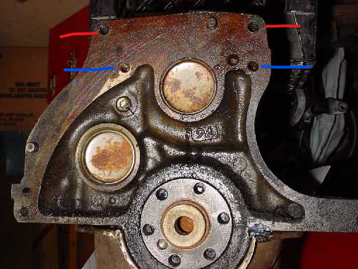

    It should be simple.
    And the 144-170-200 pilot bushing is the same.
    If the starter has 3 bolts it is a 8.5" clutch [2 bolts = 9"clutch]
    The flywheel should swap over [both engines are internal balanced]
    8.5” clutches use a “dished” 132 Tooth flywheel
    9” clutches use a “flat” 136 Tooth flywheel.
    You can't mix'n'match clutch flywheel and bell between 8.5" and 9" [it is either all one or all the other]
    Between 1966 to 1968 some of these 200 blocks have a dual pattern for both 8.5” and 9” style bell housings and clutches.
    Here:
    Ford changed bellhousing pattern for the 200 in 1968 for the larger 9" clutch flywheel only.
    The lower dowels and bolts are the same on both types , so the block can be lined up drilled and tapped for 2 uppers if needed.
    Or you can simply hunt down a 9" flywheel , Bell , Clutch ,and Starter [which would be cheap]
    You can adapt late blocks early 8.5" bellhousing but not the other way round, because the early 144- 170 blocks cannot be drilled to the larger bellhousing
    here's why
