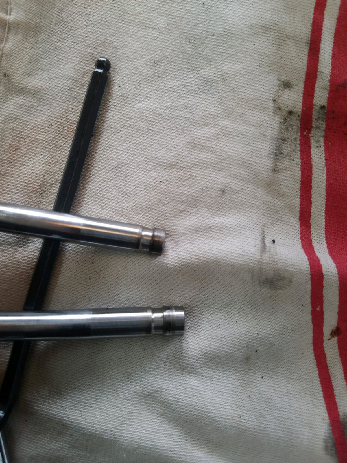

    No lash caps, just a missing top of the valve. I had to file it down to get it out of the head, but didnt seem like it was that big of a mushroom for the amount gone.
    Tony

    What I’m seeing is a parting line where the tip of the stem could have had a dissimilar metal friction welded to it. Lots of valves have a large portion of the stem friction welded to facilitate manufacturing.
    I don’t know what material your valves are but they may have welded tips to provide a hard wear surface, that valve may have simply lost the tip.

  19. It had a hardened Stellite tip on top of it,,,,it’s to keep the stems tips from getting beat up .
    If it’s gone and you can’t find it upstairs,,,,,it’s in the oil pan somewhere .
    I should have known 340,,,,those lifter bosses looked like they were angled to me,,,,,LoL .
    7000 is very reasonable for that engine,,,,good old Mopar .
