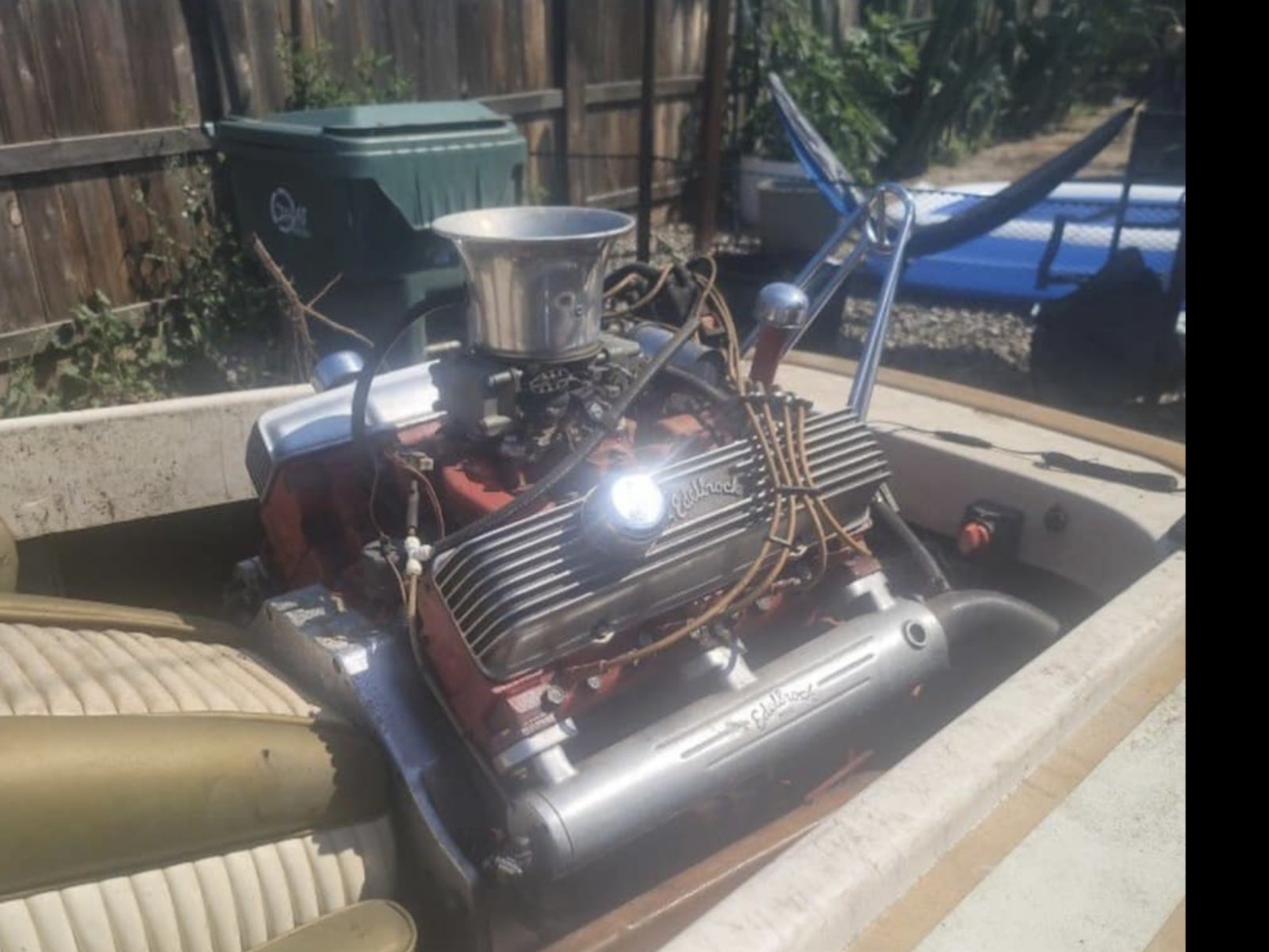

    I dig vintage flatbottom ski boats, hell, most vintage boats. While perusing photos on another site these pictures showed up with the owner not knowing anything about, well, anything. Wanting to help to at least ID the engine, I blew up the photos of what I thought was an early Cadillac engine. Nope, the distributor is in the front. Not a Packard, Not a Rambler. Not a Mopar Poly. Is it a later Cad?
    I give up. What is it? I was common enough for Edelbrock to make exhaust manifolds for it. ??? IMG_1829.jpeg IMG_1830.jpeg

  2. How many engines had a front mounted distributor,,,,leaning to the left side ?
    Looks like a GM cap there on the distributor .

    Well Mark, I think you hit the nail on the head. The water outlets on the end of each head look correct and the water pump plate looks right, the same "step" on the end exhaust ports. It's the valve covers that kinda threw me. The Edelbrocks look pretty square-ish on each end whereas the stock Cads are round-ish on the top edge.
    Great motor for an old flatbottom ski boat! Smooth and torquey. The time frame, 1963-67 is perfect too.
    Thanks....

    I guess if it is a 63 it would be a 390, 64 was the first year for the 429 IMG_9607.jpeg IMG_9606.jpeg

    If I'm not mistaken the Edelbrock parts like the valve covers and marine exhaust would interchange with the 62 and earlier engines. The 63 engines seemed like a cross over of sorts..

    Yup, I think valve covers fit from 49-67, never knew about the exhaust but the layout looks the same as the earlier ones…

    I guess it could be a second series 390. Doesn't matter.
    The boat looks to be an early Mandella. Boy, did he score if he bought it.
