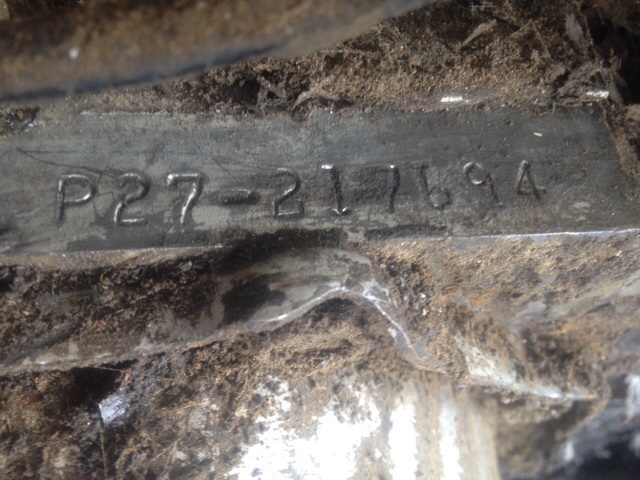

    This is all I can find...
  8. George
    Joined: Jan 1, 2005
    Posts: 7,916
    George
    Casting number is on rear face of the block. I can't seem to find my ref with the poly casting numbers, not sure if 241 Poly has a different # than the 241 hemi. '55 Hemi would be 1632229 or 1635829
  9. George
    Joined: Jan 1, 2005
    Posts: 7,916
    George
    found it. '55 259 from engine # 60201 casting number 1630392

  12. George
    Joined: Jan 1, 2005
    Posts: 7,916
    George
    Rear face of block
  13. George
    Joined: Jan 1, 2005
    Posts: 7,916
    George
    my ref doesn't show # for PLYMOUTH 241, only Dodge so I'm not sure if polys & hemis have the same casting #. dodge is 1409528 or 1613745 but those are listed for 53-4 dodges
