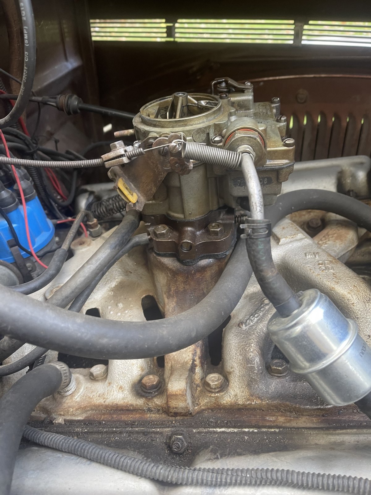

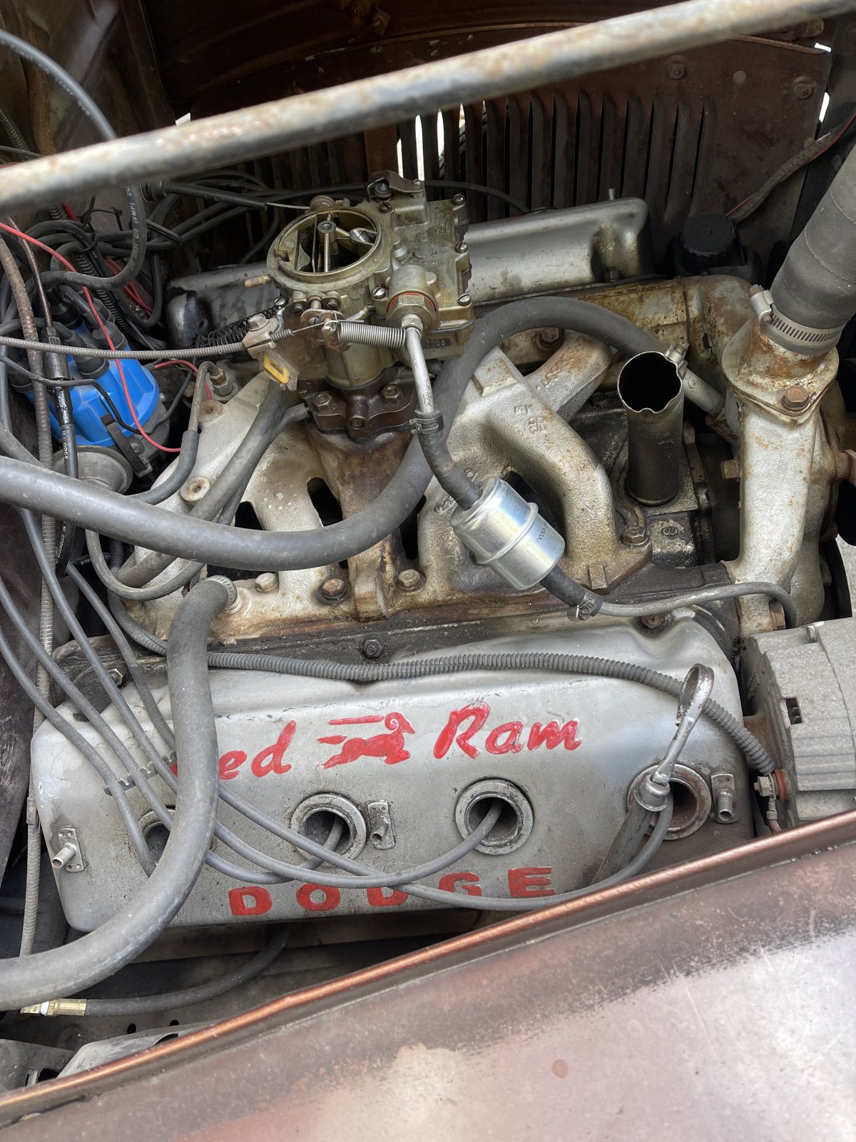

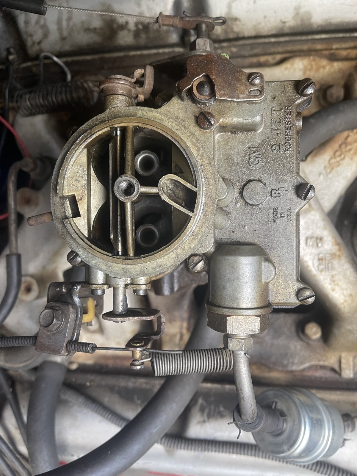

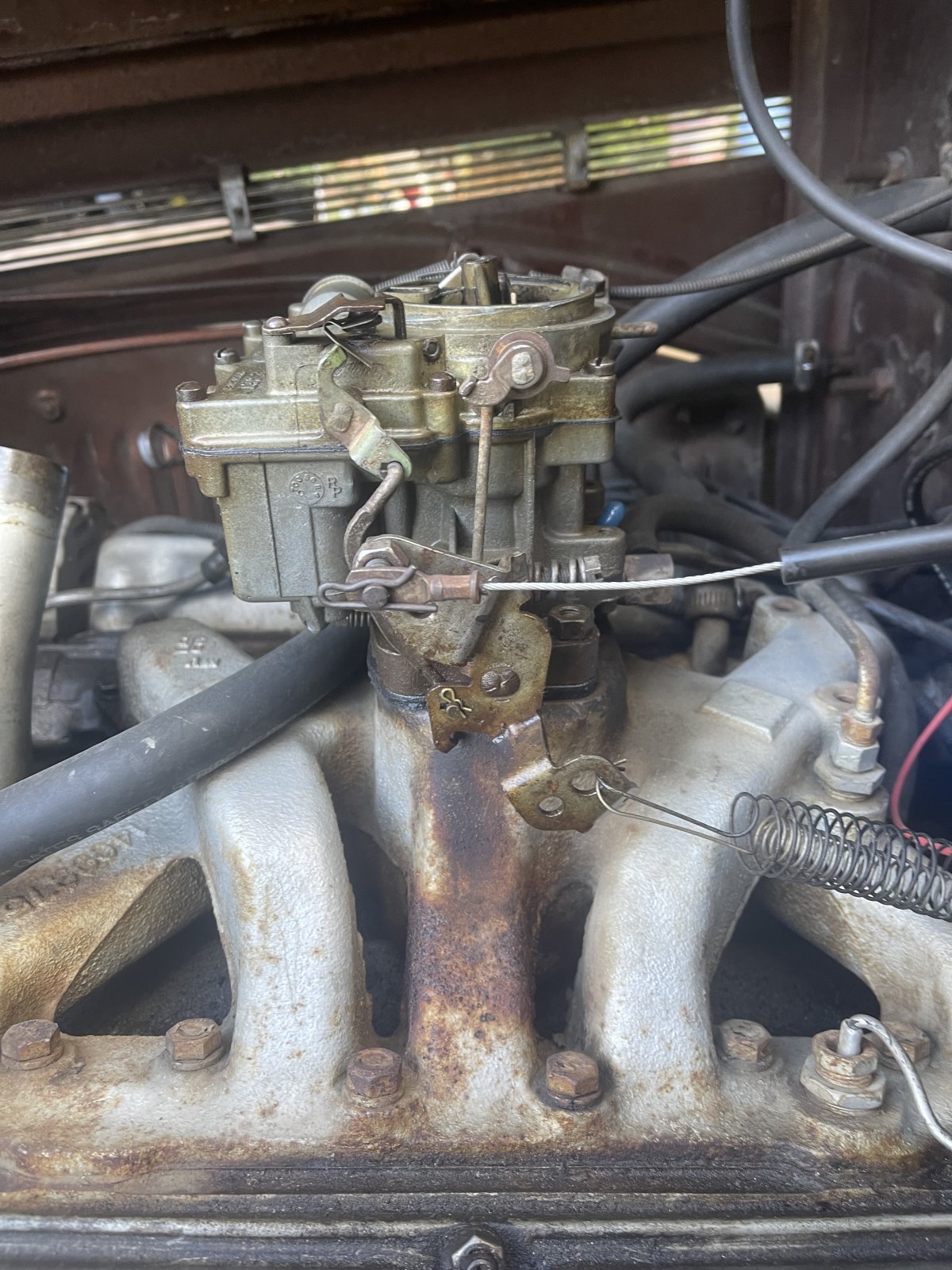

    So I bought a 1937 Plymouth with an updated engine. The value covers say red ram dodge but the carburetor is a gm so I’m a little confused as to what I actually have for an engine. Here’s a couple of photos. I’d like to know what I actually have so I can put an automatic transmission in eventually this winter

    Somebody correct me if I'm wrong but I'm pretty sure that's a 241ci "baby" hemi

    You have a little Dodge hemi with a Chevy carb on it.
    one little trick in this situation, is to use google to search for pictures of Red Ram hemi engines....and you'll see they look just like yours, except for the carb.

    That’s one of those rare GM Hemis,,,,,they just painted Dodge on the valve covers to fool everyone . Lol
    It looks to be a good engine,,,,,should work fine .
    Like Mark suggested,,,,,get the stamp code off the block and it will tell you everything you need to know .
    Those numbers and letters will be located ,,,,stamped in the front .
    In your pic,,,,,right about where the oil fill tube is located,,,,top of block surface .
    1953-1954. Red Ram. 241 CID
    1955. Super Red Ram. 270 CID
    1956-1957. D500. 315 or 325 CID
    You can get the codes in several places,,,Hot Hemi Heads is one of the easiest to find .
    By the way,,,those valve covers doesn’t mean that’s what is,,,,they will fit other engine sizes .
    However,,,only Dodge covers fits a Dodge .
    Also,,,,Chrysler only fit a Chrysler,,,,,and Desoto only fit a Desoto .
    Plymouth didn’t have a Hemi,,,,,it was a Poly .
