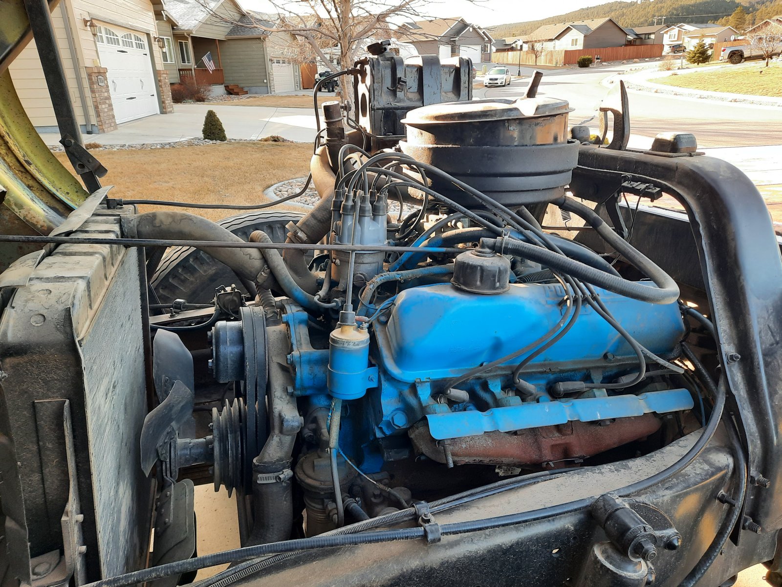

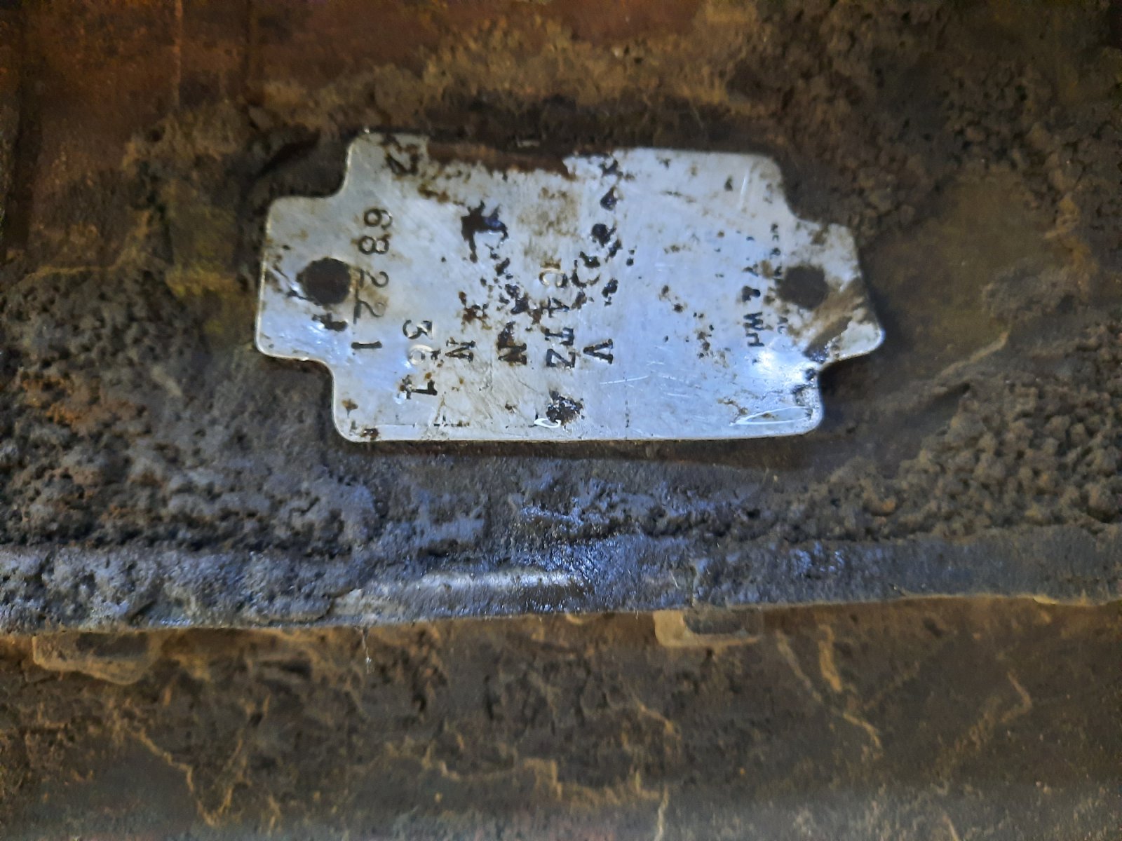

    tag says it's a 1964 361 (the bigger truck version of the 360).
    if you can believe the tag. Usually a good idea on FE engines to measure bore and stroke if you want to know the real displacement.

    I have read that the 1 in 361 means it has a forged crank.

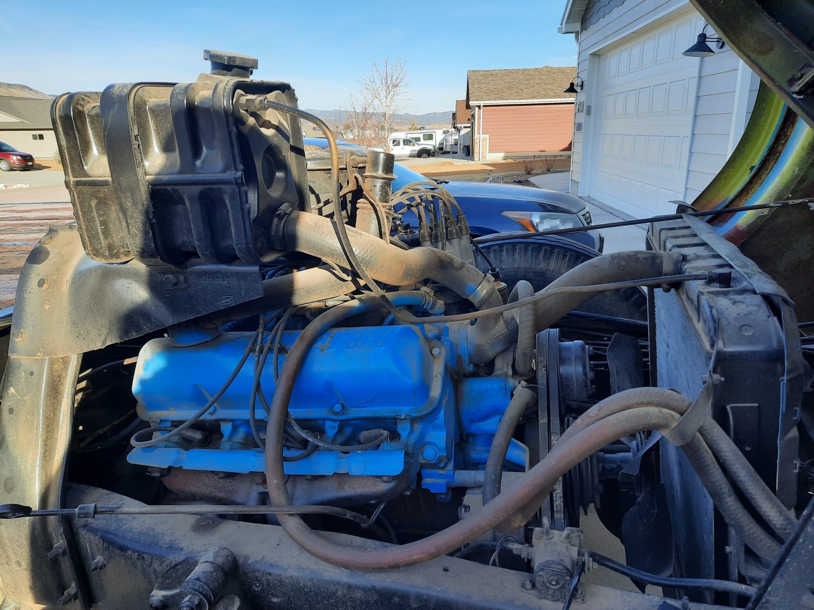

    Yep. FT Ford. Think FE with upgraded internals like a forged crank, better rods, high flow water pump, more heat resistance valves, and other tweaks to prepare a car motor for duty in a heavy truck. You can also tell by the heat riser exhaust p***ages in the center of the cylinder heads.
    Displacement is anybody's guess after 52 years. The overspray would lead me to ***ume it has been gone through at least once. Easiest thing to do would be to pull a plug and use a straw to measure stroke. 3.5" = 330 or 361, 3.78" = 391.

    I’ve rebuilt a few of those and generally they use 7/16 sodium filled exhaust valves. No big deal if it’s running ok and your using as is but they get expensive and don’t flow to well. They can be converted though.
