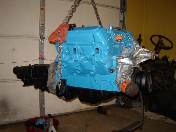

    I'm going with a Buick V6, the one pictured is just a 2 barrel, picked another one up the other day that's a Turbo.
