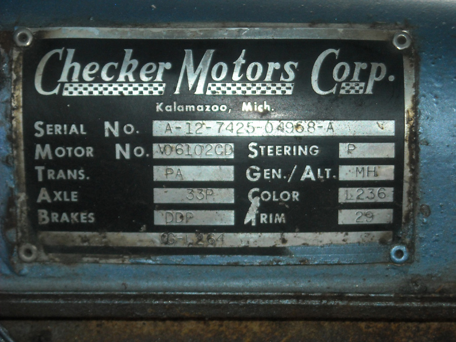

    I can't get to the casting number on back of engine (under distributor) so this is what info I'm able to provide...
    Vehicle: 1970 Checker Marathon- V8 SBC, GM 2 Jet Rochester Carb., Stock single exhaust (rams horns),A/C & Heat, Automatic Trans., Power Steering/Brakes, Rusty Ol' Sumbitch
    Vehicle Serial #: A-12-7425-04968-A<O:p</O:p
    Motor #: V06102CD<O:p</O:p
    Color: L236<O:p</O:p
    Trim: 29<O:p</O:p
    Trans: PA<O:p</O:p
    Axle: 33P<O:p</O:p
    Brakes: DDF<O:p</O:p
    Intake manifold #: 3916313<O:p</O:p
    Drivers Side Exhaust manifold #: ?
    Passengers Side Exhaust manifold #: 3989036 RH 39 GM
    Stamp on front right of block (under generator): V06102CD<O:p</O:p
    (This is stamped just left of it. What does it mean? 8 cylinder?) à C-8<O:p</O:p
    My research has not described or identified the extra #2.(V06102CD) What does this mean?

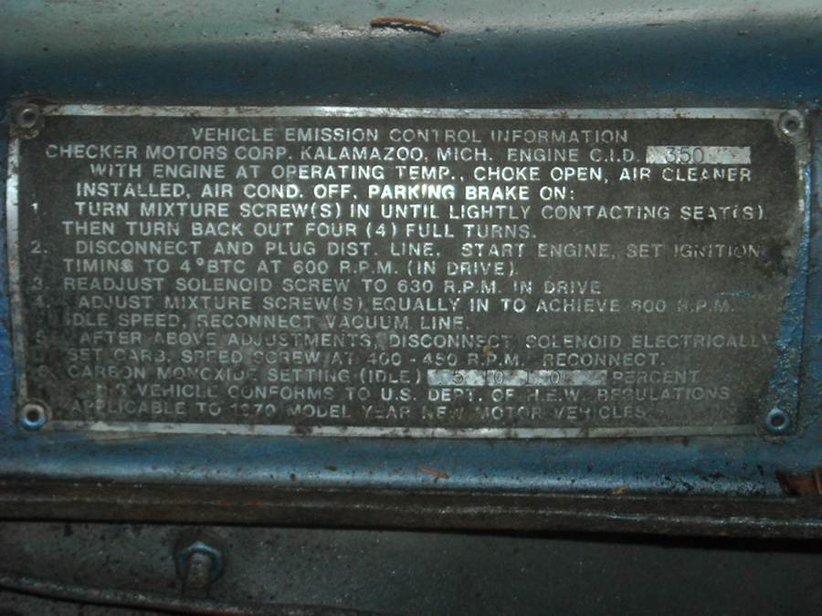

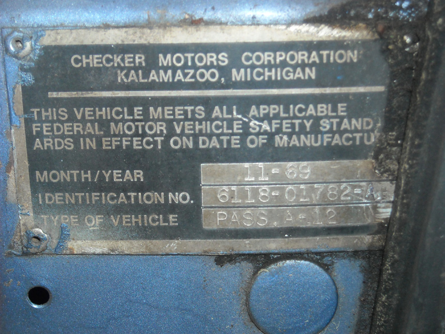

    Found the Rochester 2 jet carb serial# 7029180
    Info from metal plates:

    Well thanks for all your help guys. I found the engine casting # and got the heads too. Pretty dirty under valve covers...
    engine - 3970010
    right & left heads - 3932441
    Also, whoever put the post (then removed it) showing a picture of where the engine casting number is located -- thank you, it helped!
    So i have a 350 and that anwers my question.
