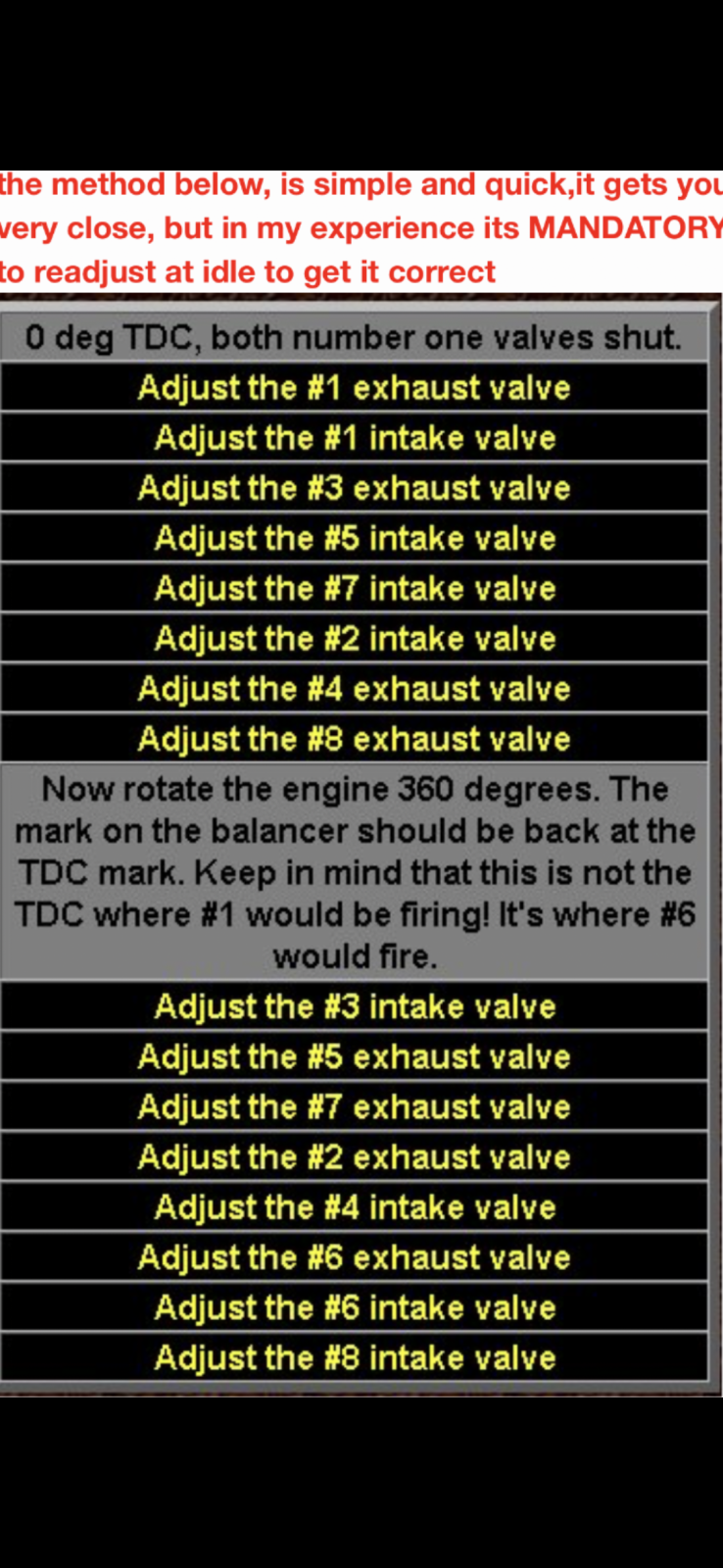

  7. Johnny Gee
    Joined: Dec 3, 2009
    Posts: 14,609
    Johnny Gee
    from Downey, Ca
    The lower half of this chart. You did say depressed? 4AE1A29F-D675-43D8-B6FA-0CF243D45870.png

    from Florida
    Twenty8 is the man. I screwed up. Iam an old mopar guy 18436572 but yes the l82 is different. So do the cams interchange. What if someone put a cam from a l98 into a l82 block. The firing order would change. Nice adjusting chart, what is the typ gauge thickness?

    Wish I could use the sprocket dots but the timing cover is on. Is the above chart for adjustments based on 1-8-7-2-6-5-4-3.
  19. Johnny Gee
    Joined: Dec 3, 2009
    Posts: 14,609
    Johnny Gee
    from Downey, Ca
    Yes. FYI, having the two dots next to each other is not on a compression stroke even though the piston is at tdc.

  21. Mr48chev
    Joined: Dec 28, 2007
    Posts: 36,204
    Mr48chev
    The chart that Johnny Gee posted in post 7 is the primary one I have seen for SBC.
