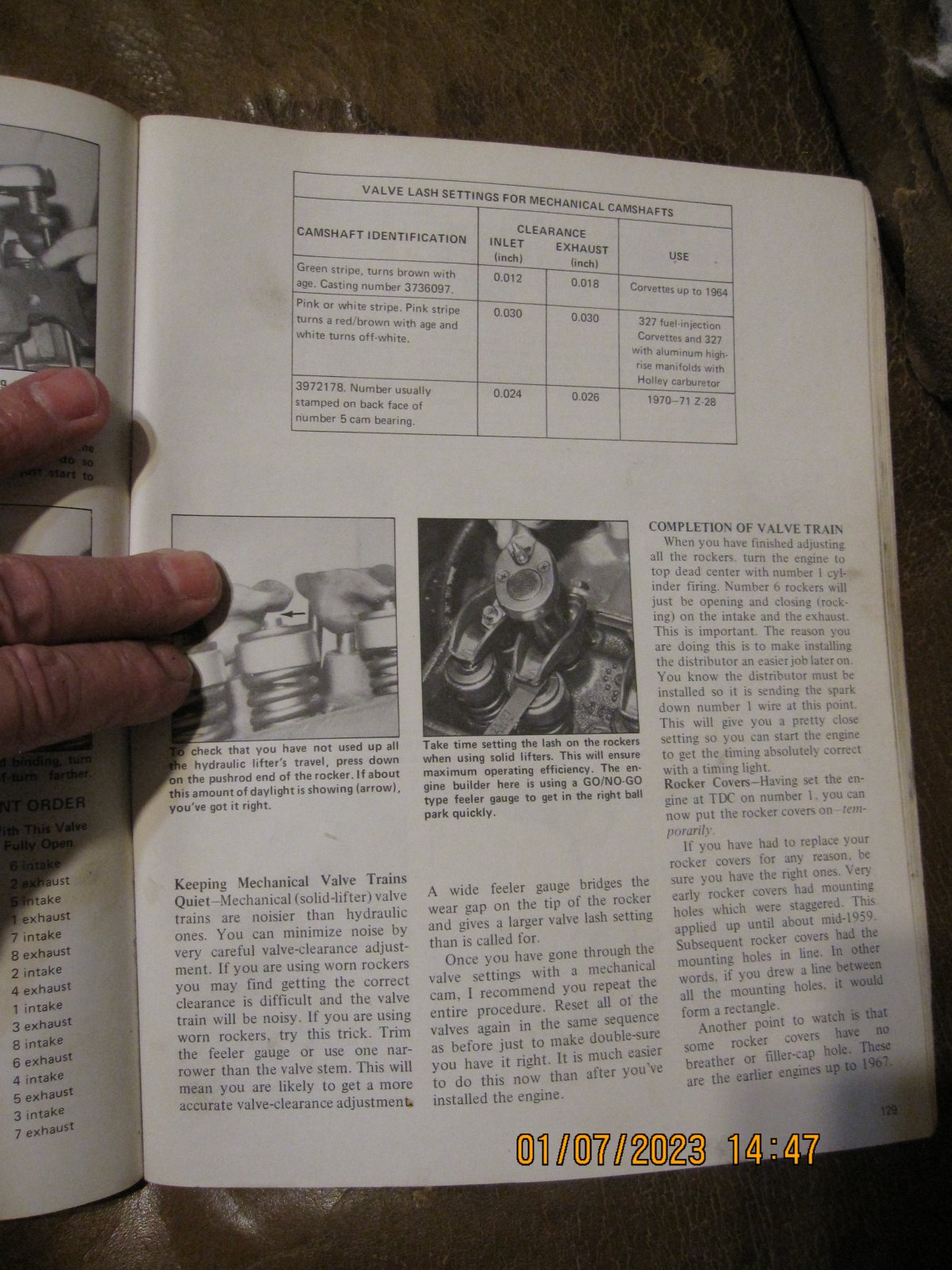

    Doesn’t matter. Hydraulic lifter get adjusted the Same way. Tighten slowly as you spin the push rod with your fingers. Stop just as the pushrod stops spinning. Add 1/4 turn. That’s how I do it anyway. Lifter on the base circle by the way.

    Some guys (I guess who don't know math) either look up "valve adjustment" in the shop manual, or if not available, just adjust the rocker that is NOT opening a valve.
    Oh, and the BS about having to readjust them after you get it running, is only for guys who can't do a "cold" valve adjustment. Many later cars won't run with one or both valve covers off (too many accessories/brackets removed)

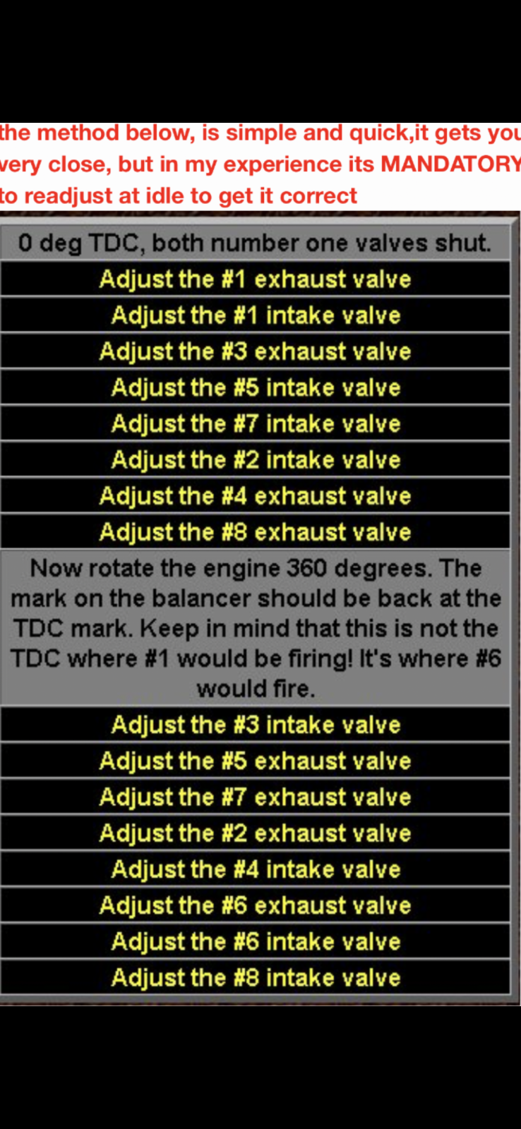

  15. The guys at MOPAR already figured this out for ya. This will work exactly fine for adjusting your valves on your small block chebby.
    Budget36, Johnny Gee and NoelC like this.

    I’ll be darn, I have a 318 in the shop, never new it was the same order as a SBC.

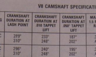

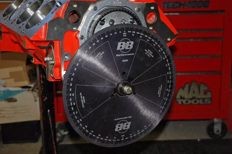

    @NoelC So you ARE referring to 360º of camshaft rotation. Most of us who build engines and use a degree wheel put it on the crankshaft, which requires consideration of 720º of rotation in order to adjust valves, or in the case of the OP's question, to know which valves are in what position at a given cylinder's TDC.
    By the way, using your method of "looking down the barrel of a cam shaft" is well and good for an inline engine. You will discover a valve-bending error of dividing 360º by eight if you're dealing with a 90º V8, because four of your "360º divided by eight" results will have to have an additional 45º (of camshaft rotation) added or subtracted, depending on whether you are counting clockwise or counter.
