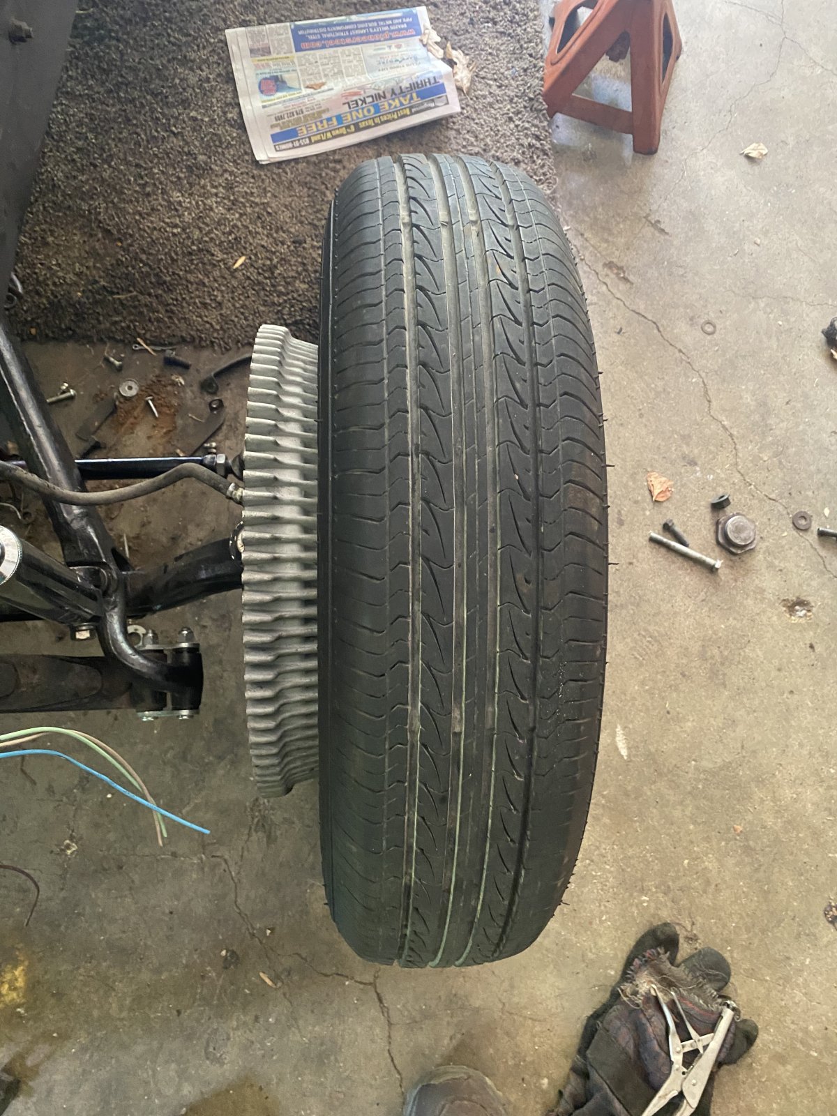

    I am back to work (finally) on my project. 53 Studebaker Starlight Coupe with a 59 Buick 364 Nailhead I am installing. I have bought a 66 SP 400 transmission and have the bushing/flywheel/starter adapter/etc. to make that all work. I do not have the engine/transmission mounted permanent yet and am starting on that this week. Headers are out of the question because of budget (they would have to be custom made) and zero clearance. The stock Buick left side manifold fits the right side with plenty of room, so I have located another left that I can buy. The stock right one is just huge and won't fit. The stock left manifold on the left side hits the steering box. I know some engines are offset from the factory, but thought I would ask some advice from the folks here that know way more than me. I only have to shift the engine maybe 1/4" + to give me plenty of room for engine flex. I would leave the transmission centered or should I move that over also? Any advice appreciated as usual. Thanks.

    Move the trans too. They should be parallel to the car’s centerline.

  3. 1biggun
    Joined: Nov 13, 2019
    Posts: 1,024
    1biggun
    A 1/4 " IMO is not a big deal weight wise and could be compensated for .
    Id move the trans over to but it's not a huge deal . Especially with a full finder big car with nothing sticking through the hood .
    the difference in balance is likely less than if a p***enger is in the car or not
    Look at some of the old F1 cars the engine is offset and crooked to get the drive line were it needed to go.
    I had a 65 kaiser jeep m7if and i had the engone over almost 2" to get the frnt drive line to clear the engine / transmission no big deal on somenting that big .
    can the box be moved slighty ?
    cool car .

  4. 1biggun
    Posts: 1,024
    1biggun
    I agree
    Id still slot the trans mount holes or what ever can be done then the fan is square to the radiator as well . Drive line can be at a angle

    The universal joints will make it work properly. Move the ****** with the motor as said above. 1/4 inch is not much.

    engines offset are common . up to a few inches nobody will ever know just keep it parallel to your centerline as in offset equally motor and trans in a strait line

  14. Move it over but go more than the 1/4" you mentioned. Clearance to the steering gear is one thing, but you also have to consider heat transfer. Be on the safe side and go 1" or more and keep the engine/transmission centerlines parallel.

    Even moving the engine/trans a couple inches isn't a big deal, nor will it affect driveline vibration. Since whatever you moved sideways changes both ends of the driveline angle equally it still cancels it out. Wouldn't matter if you shifted the engine sideway a little, or had the differential offset to one side as so many cars have had for many years.
    Mopar shifted the big hemi powered cars a full inch to the p***enger side at the factory and no issues.

    With the engine/transmission/pinion shaft all central within the vehicle, pinion angle is only a concern in the vertical plane. When you start offsetting the engine/trans within the vehicle, and the pinion may also be offset, you introduce pinion angle considerations in the horizontal plane as well.
    You will need to allow for the 'combined total pinion angle' that results from offsets in the two planes (compound angle).
    Get it between a maximum of 3* and a minimum of 0.5* (matched to within 1 degree) at each u-joint and you will be ok.
    The closer you can get down to the 0.5 degrees the better.
