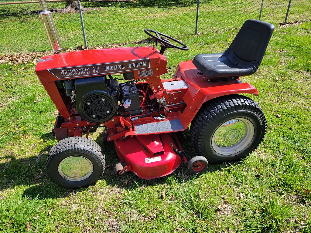

    I am a huge fan of using "Tractor Enamel" for "cheap and quick" engine paint jobs. I even used it on the 16 hp Kohler when I rebuilt my 1969 Wheel Horse garden tractor two years ago. Air Cooled engines run much hotter than liquid cooled, and the paint has held up very well in that application. Using the recommend primer seems to help improve the finish quality.
    All of these engines were painted with tractor enamel, most have been in service for many years.

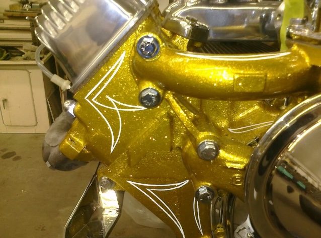

    Epoxy sealer only on the cast iron, no high build primer. this is Gold mini flake underbase followed by House of Kolor candy pagan gold topped with 3 coats of PPG Urethane clear. after 15 years still looks great. An engine (except for the parts near the extended exhaust ports) get no hotter than a black car sitting in the sun. Use real paint, you will be happy that you did. the most important thing is getting it clean before you paint....
