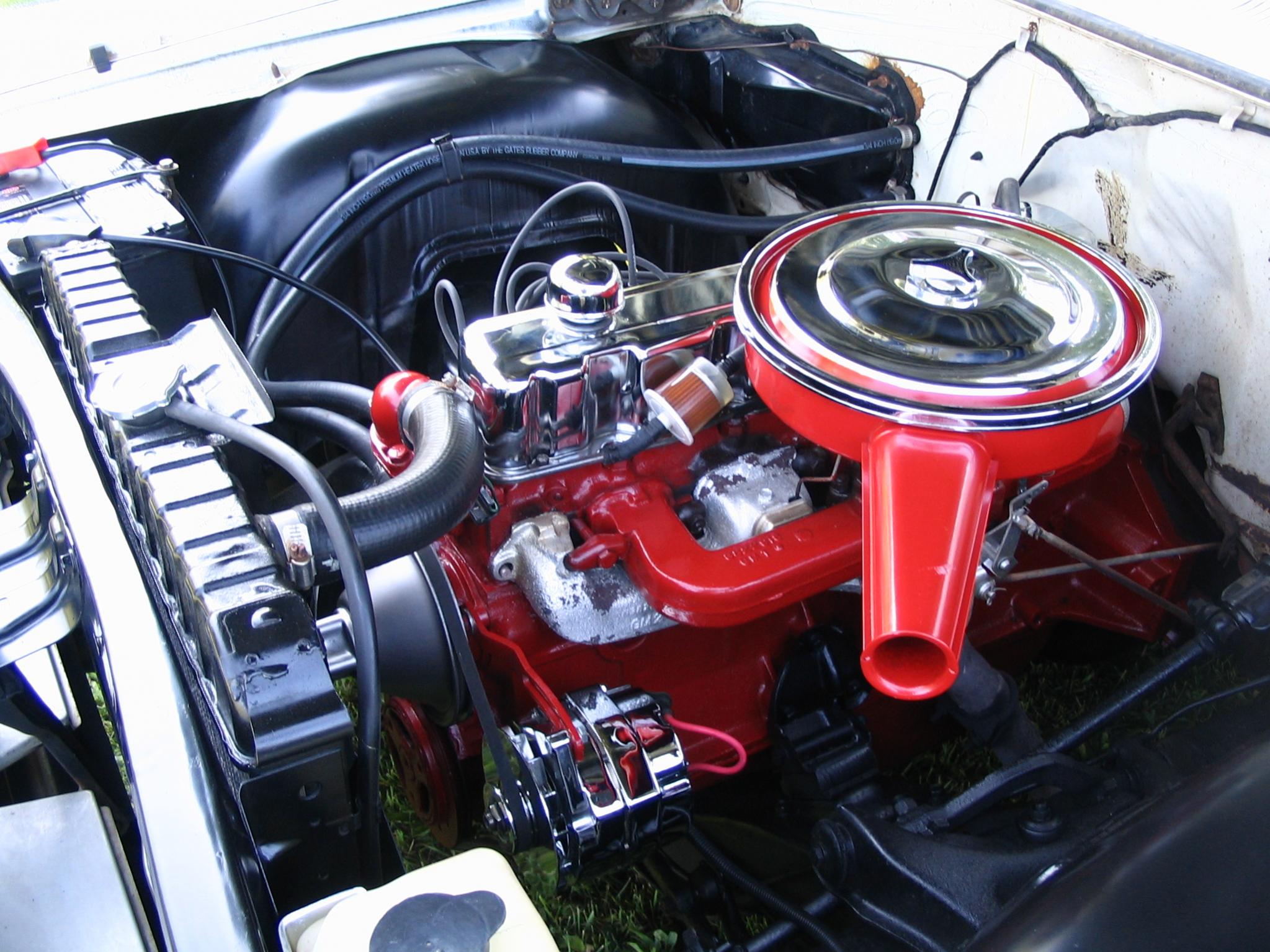

  25. I have ground the block-sprayed it with epoxy and then painted single stage urethane and had excellent results.
    In the pic below-I painted it in the car-washed it with laundry soap after i degreased it and painted it with a brush/spraybomb combo and rustoleom paint-worked good too

  29. cederholm
    Joined: May 6, 2006
    Posts: 1,754
    cederholm
    Painting it is easy, cleaning the thing to be good enough for paint is a little harder. I used a cast-iron replication paint from POR-15 on my 235 - you can kinda see it below. I've also used rattle can paint in the past.
