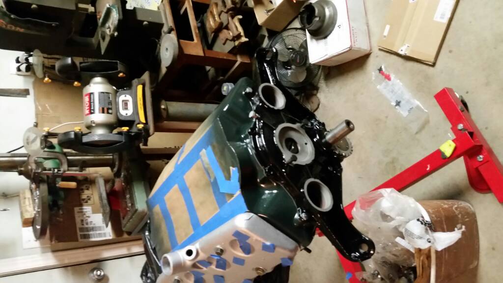

    Look at por 15 paint I absolutely love it and have been painting all my engines with it 1479971878526.jpg
    Sent from my SM-G900V using The H.A.M.B. mobile app
