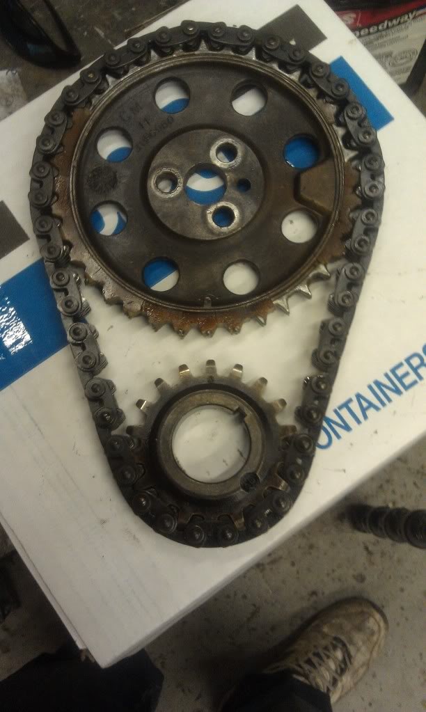

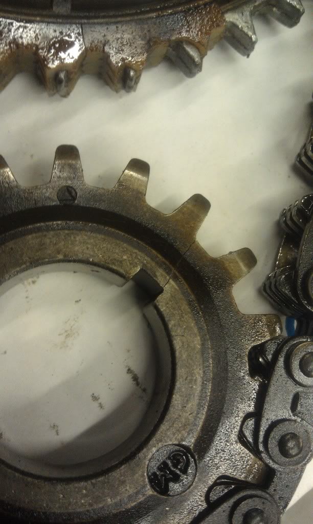

  26. the thing that makes me keep fooling with this is, it was a decent running car before it was parked. i have pulled frozen junk out of the woods and was able to get them started. could a timing gear jump and there would be no play?
  27. while cranking it chugs smoke out of breather.
    You left that part out. :)
    That's a pretty serious case of blowby
    Yes they can jump on the nylon gears
    tb33anda3rd likes this.
