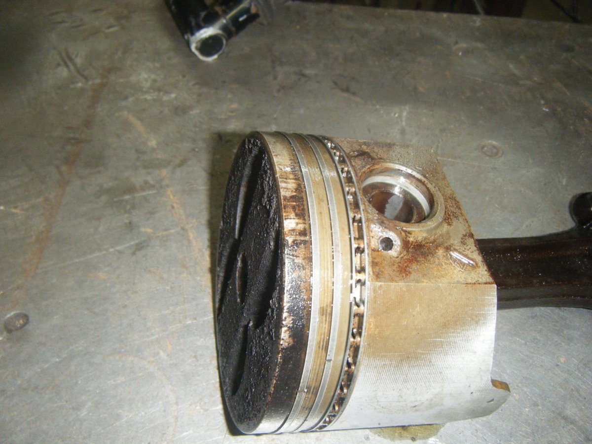

    had a little time and pulled off the intake and valve covers, and removed the lifter tray, rocker arms and pushrods. i can spin the engine with one hand using the flywheel.
    pulled one head, motor was definitely NOT rebuilt, although the cam, lifters and timing chain look new.
  13. tb33anda3rd
    Joined: Oct 8, 2010
    Posts: 17,588
    tb33anda3rd

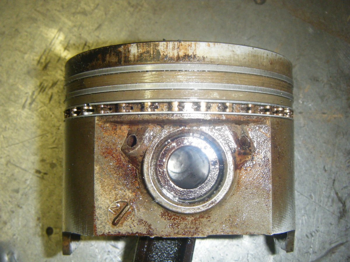

    i just pulled the pan, the other head and timing cover. then i pulled number 1 piston. definitely not rebuilt.
    piston rings frozen to piston and wore down even. i could not get them to move with my fingers and i actually slid the piston back into the motor without a compressor. DSCF4604.JPG DSCF4605.JPG DSCF4606.JPG DSCF4607.JPG
    firstinsteele likes this.

    Ok but is there a way to tell if the piston ring situation was caused by the attempts to start it and the real culprit was simply hung valves from the engine sitting? The engine has not jumped time and exhibited normal compression on 2 holes. It has fuel and spark. I'm gonna suggest that there were hung valves, and the attempts to start/diagnose the engine is whats wrong with it now. The OP stated that the engine would spin over by hand with the valve train dis***embled. What became of the two holes with good readings. Those 2 holes should still have compression since the valves are now fully closed. Some of the observed conditions don't make sense. OP, can you comment on all of the valves in both heads being fully seated after the heads were pulled?
  16. tb33anda3rd
    Joined: Oct 8, 2010
    Posts: 17,588
    tb33anda3rd
    the valves "looked" ok. and the 3 i did the leak down test to [worst three] all had no air coming through the exhaust or the carb.
    i would also like to know what would cause the rings to freeze to the piston. the piston shown is the only one i pulled, the piston was removed with the crank up [motor upside down] and when i tapped the cap bolts down, the piston slid [gravity] to the bottom of the hole and would have fallen out if not for the ridge.
    i was hoping an engine guy could explain.

    There is no mystery really. tb33 told me earlier this year, that this car was a long time project.
    The rings likely stuck long ago from varnish. When the car was finally ***embled after cosmetic restoration, the car ran ok. With completely stuck rings, each time the motor is run, the blowby gets worse. That is from minor cylinder taper, and the stuck rings and the bores wear rapidly as the piston rings wedge tighter at the bottom of the bore.
    I have an early Olds motor that did the same. It got worse the more times I ran it. I was running it each day to try to unstick the rings, but they never did. The engine got more difficult to start over time. Ran fine, if you could get it to start.

    @F&J, your post gave me the "ah hah" moment. this makes sense now. we were under the impression this motor was rebuilt. it wasn't and was marginal, at best, and the final straw was the customer flooding it and his trying to get it started. the customer told me today he was putting a quart of oil in every 500 miles.

    I've seen motors like this that ran when parked but wouldn't a couple weeks later. The excess fuel in the oil was the final nail in the coffin. The rings were already sticking and probably had plenty of sludge around them from the oil consumption and resulting sludgy blow by. The flooding of the engine washed the sludge away from the rings and they no longer held enough compression to run. My wife drove her Chevy home one day with smoke billowing out of the breather and every other possible opening in the engine. It had had the oil changed and was flushed to clean it out the day before and all the sludge that came out was keeping it running to that point. I was able to spin it over with my hand on the crank pulley. Flooding didn't destroy the rings, it cleaned them which removed the sludge that helped them seal.

    As I said back on page one, the piston rings are stuck.
    Now soak the pistons in diesel fuel for a few days.
    They will come out with effort.

    that will be a job for the engine builder, he may have to bore it and the pistons will be replaced.

    those are factory pistons , have several buckets of them in the garage with and without rods , do not waste you time reusing them as the tin coat is worn and you will get a slight tick when cold like a forged piston ,
    the rings are gummed from the carbon build up , if the motors heads have been changed to a low compression large chamber style head ( thats how you change compression ratio in a Pontiac and most people just swapped heads when a valve job was done and accidently give there proper chamber heads away (always check the ac bracket casting number for cc's )) with the low compression the piston tops will carbon up and the motor runs hot anyways now it will run hotter and the rings start gumming up . when we would re ring them they often were so stuck you had to pry them out even after soaking in a solvent tank for 2-3 days and then you had to clean the grooves with the ring tool ( or broken ring ground down ) , as for the bearings not bad shape if they are factory ,
