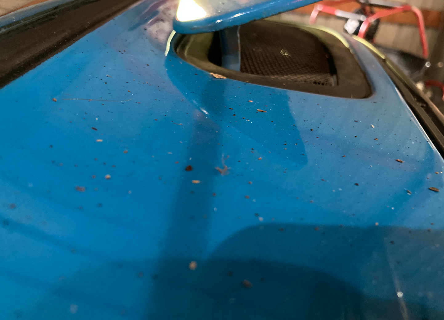

    I’ve been getting comfy with the coupe since the rebuild where I focused on the Late 50’s - early 60’s era. The goal was to stay true the more common speed parts of the era: 311 small block (first year 327, destroked and bored) the right heads and all the goods including a 4 speed Hydro, Hydro-Motive compe***ion transmission. So like points, I choose to run a generator, not a look-a-like to be true. Friday I found the small block revs quick, somewhere around 7k my reman Delco generator went pop and flamed out… covering my vintage paint in a cloud of copper winding sparkle dust.

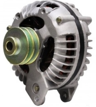

    Dump the generator and adapt a early 60's Mopar alternator. Mopar started using alternators in 1960 as a option on Chrysler models because of all the electrical stuff on them. By 61 they were standard on all Mopar cars. It will operate better than the generator and still be period correct. I have one i will be adapter to my 39 and for the 259 Stude motor slated for my 32 Tudor. I love the look of Generators, but hate how they work compared to a good alternator set up. Easy upgrade and they look pretty cool too.

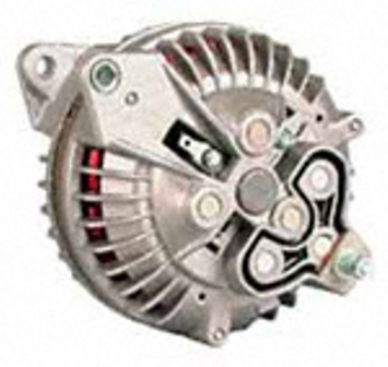

    Same basic design from 60/61 all the way to 87. They still require a voltage regulator, which keeps the old vibe, and they span such a long period, parts a readily available. Honestly I'm surprised you don't see it more often on 60's period hot rods.
    This is the early round back design used from 60/61 through 69.
    Roothawg likes this.

    Just make sure to get an early one, from the 60s...they redesigned them for the 70s, to use an electronic voltage regulator, but they also made the diode area larger, and "square" looking. Most folks don't notice, but I sure do :)
    and the early ones are getting harder to find, the chain parts stores sell you a later one in place of the early one.

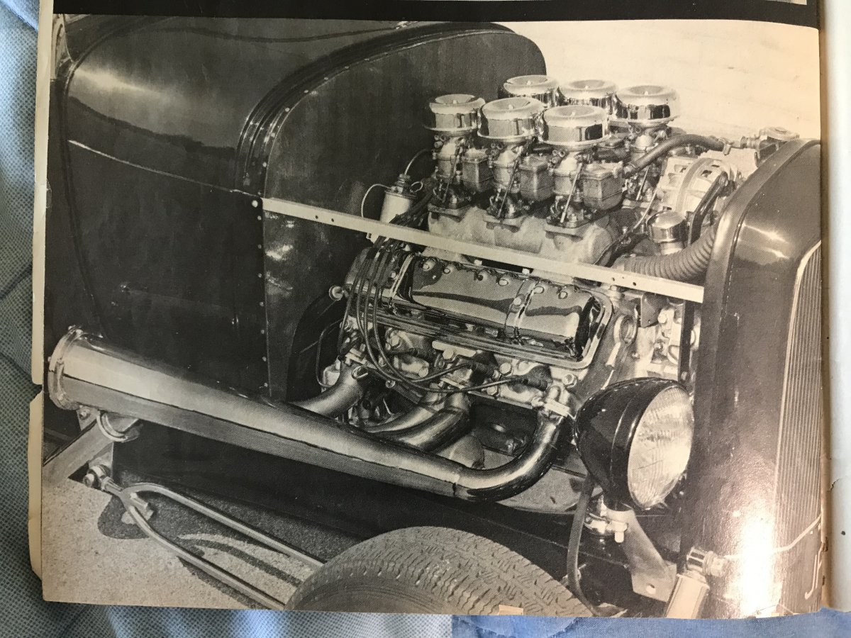

    As an example of one used back in the day, Here is a PIC i got from another thread here on the HAMB a while back showing it being used on the Sam Conrad Roadster. This would have been between around 64 65 most likely. Sam Conrad was a member of the LA Roadsters and his 371 Olds with a hydro powered 29 roadster on 32 frame has infected my brain for many many years.

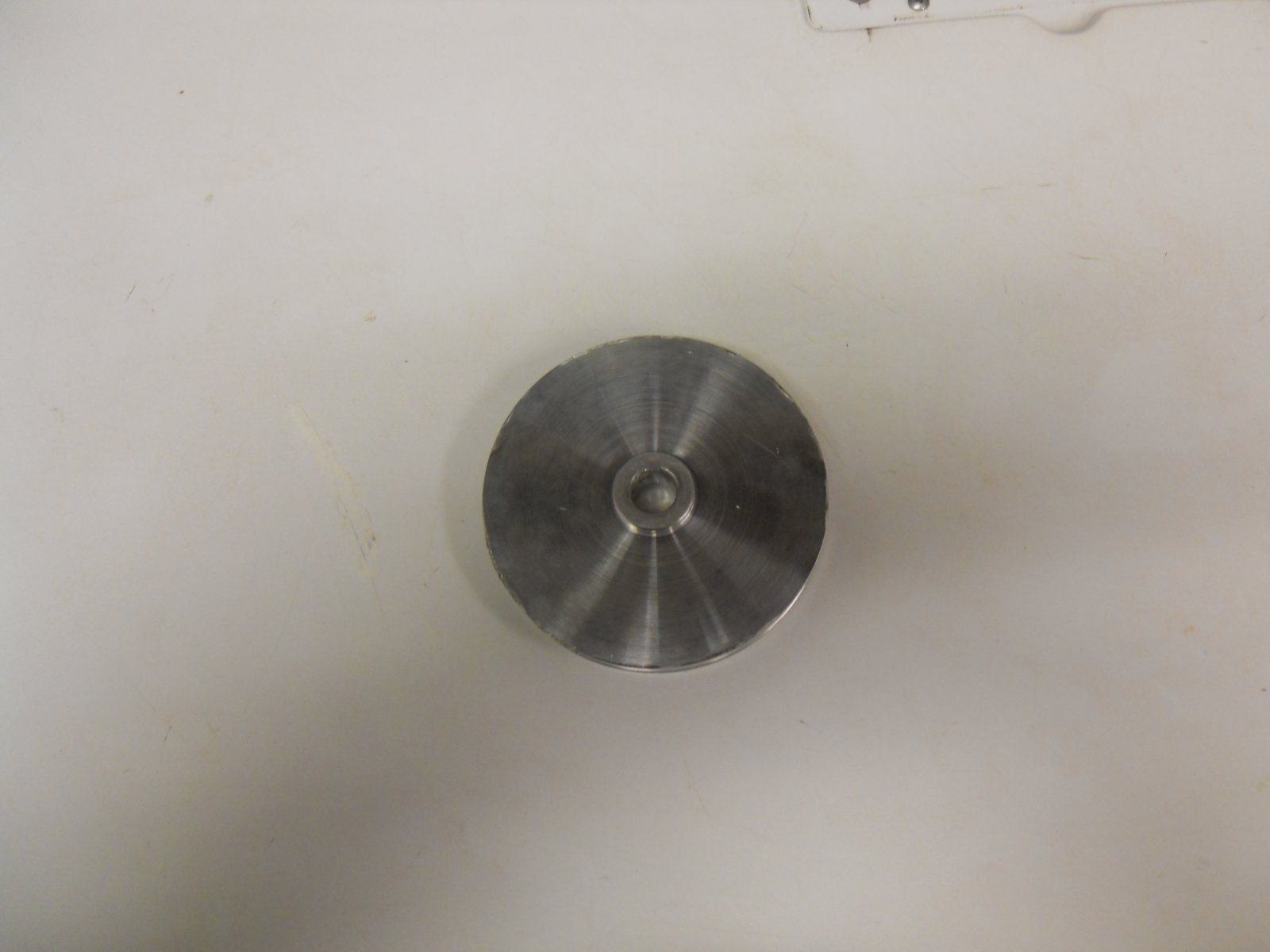

    Here's what you need. Frankly, I'd use an alternator with the separate voltage regulator.  pulley 5 2.JPG pulley 5.JPG
    Nailhead Jason and 427 sleeper like this.
