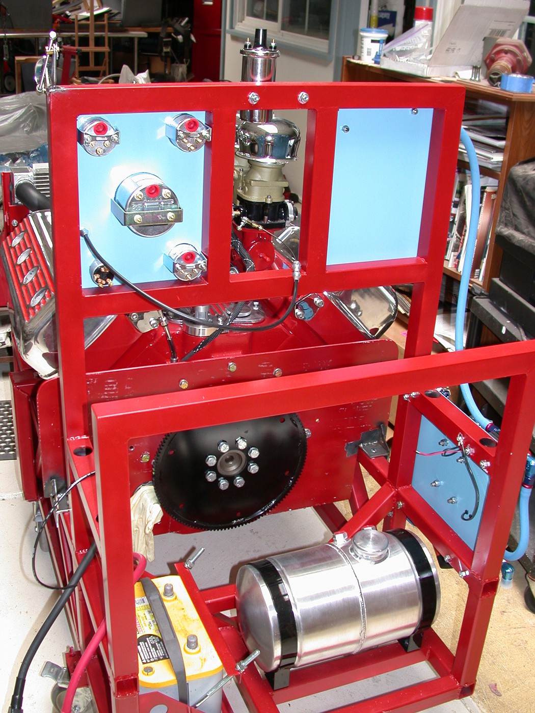

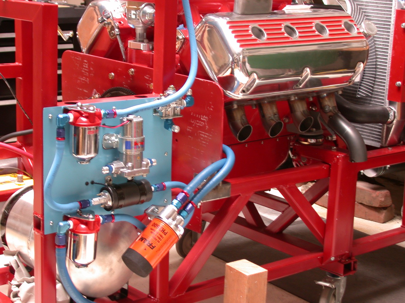

    I put this one together using left over steel I had laying around about 15? years ago.
    it's been quite handy having run an engine on every year or so.
    in the down times it's something to hold the spares on,
    easy to roll around if needed
    here with a '63 394 Olds after cam run in

    Great looking engine stand.......great looking and sounding motor........but......do yourself and family a favor and put a shield or cover over that trans yoke on the tailshaft. Those of us with agricultural experience know only to well what an open shaft or PTO can do to clothing and the human body.

    I'd have to build a way back machine, that setup sold a long time ago

    I built this run stand a few years ago just to break-in Chevy SBCs. I only put a deuce grill shell and radiator on it because that's who I am....an old hot rodder. I am currently ***embling my LAST 327 and then I intend to sell the run stand and all of my equipment and all the 327SJ parts (blocks, heads, cranks. etc). The run stand fits only SBC, is powder coated black, has a nice dash with ignition switch and oil pressure gage, mounted battery and gas tank and electric fuel pump. I now use sprint car headers for the exhaust. I will put up some better pictures of it later today. gold 283 (1).JPG

    I would make a cover for Exposed flex plate. Worked in manufacturing... sensitive to exposed rotating parts.

  25. I just mounted a 401 buick in mine and never even thought about the open flywheel ,Makes me really nervous,especially when revving , once I take the engine off the stand changes will be made to use the bellhousings with future engines
