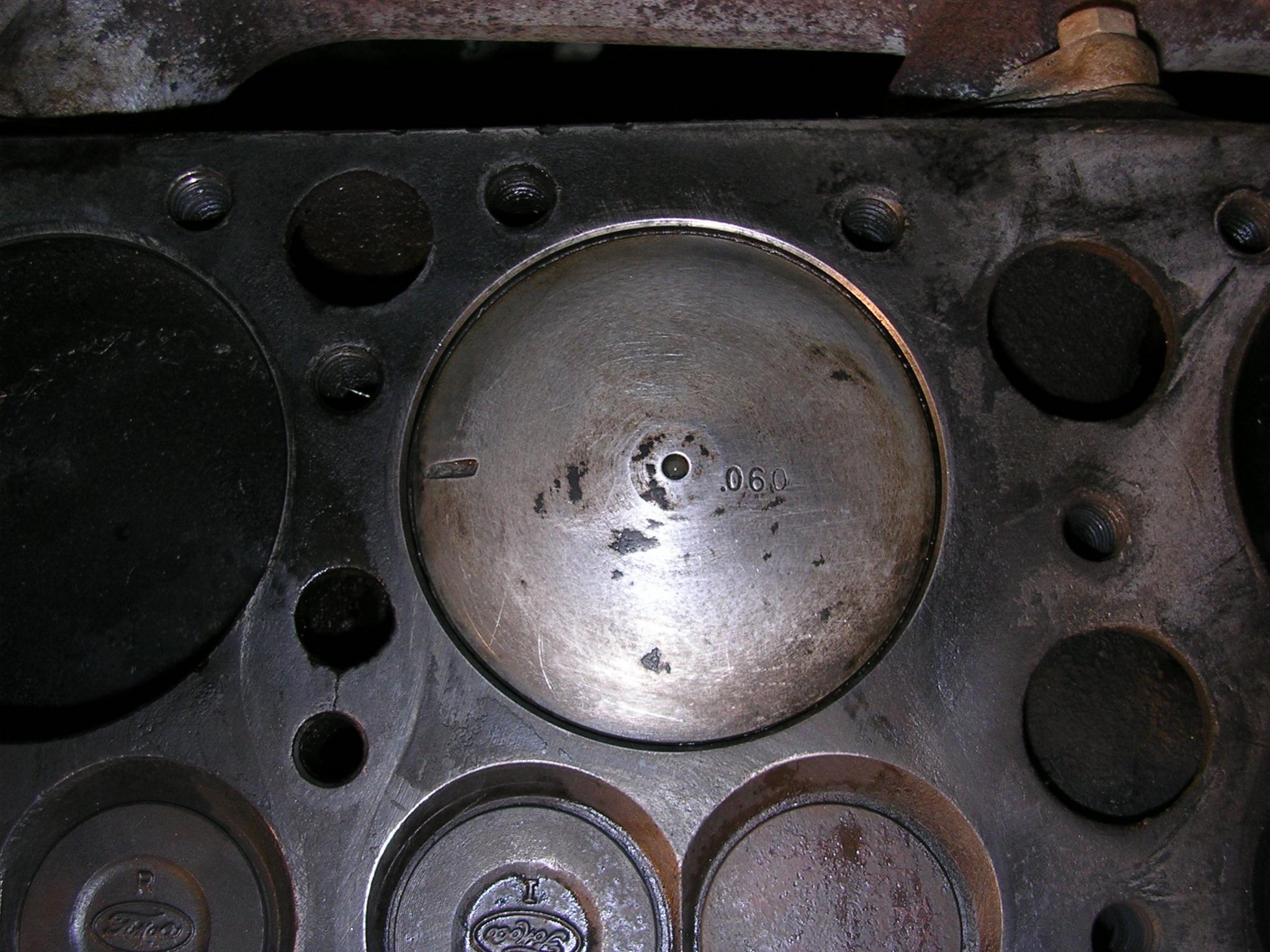

    I just finished rebuilding an engine for my 53 Merc. Had the new block magnafluxed - no cracks. Bored out to .60 over. Reused the pistons, rods, crank and cam. Had engine fully balanced. New rings, berings, and bushings. Fired it up last night and all was well. Took it out for a break-in run today and got about 2 miles and it seized. Oil pressure was 45 lbs at 30 mph. Temp was 170. Was running great until I came to a stop and then it just seized. Tried to turn it over by hand (2’ breaker bar on the front pulley bolt) with no luck. Drained the oil and nothing in the oil. Any suggestions....... before I pull the engine. <!-- / message -->

    When you bore .060 you need .060 pistons.

    The resused pistons were already .60

    Guarantee they arent .60
    The way you said it we though you bored it out at rebuild.

    By way of more detail. My old engine was already bored out to .60 +. I had a crack between an exhaust valve and the cylinder so I decided to get a new block. Found the block and had it maganaflux to insure there were not cracks. Decided to use the pistons (.60), rods, crank and cam. Had new cam bearings pressed in, used new rings, rod bearings and main bearings. Had the engine balanced. Cleaned up the heads with a .008 cut. Resized the rods. Cut all seats. Installed exhaust seats. New pin bushings. Polish crank. Drilled intake for adjustable lifters. New adjustable lifters.ffice
    Stock engine except for the over bore with an automatic trans. I was test driving it up and down the road in form of the house. Did three laps (about 6 blocks)...came to a stop to turn around and the engine stopped and will not turn over.<O:p</O:p

    Lets put decimals in perspective for you. You still insisting .60 makes me wonder about the bearing tolerances.

    .060 not .60
