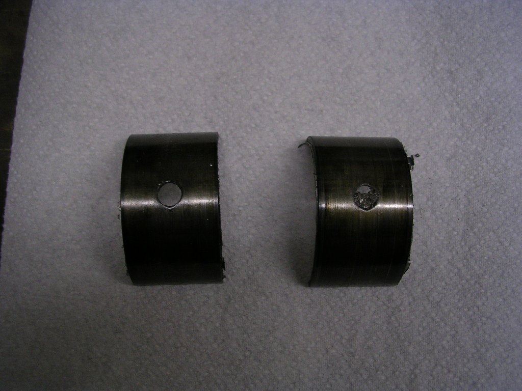

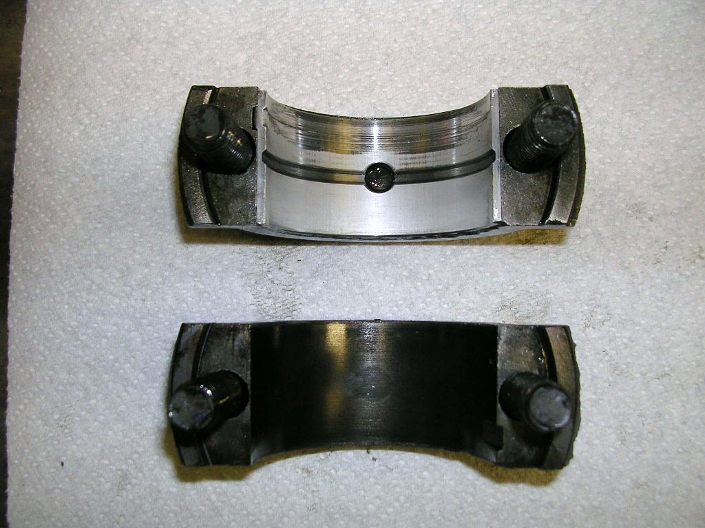

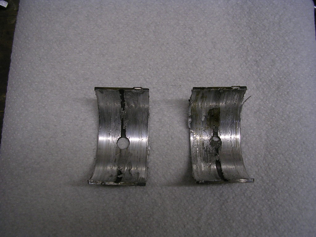

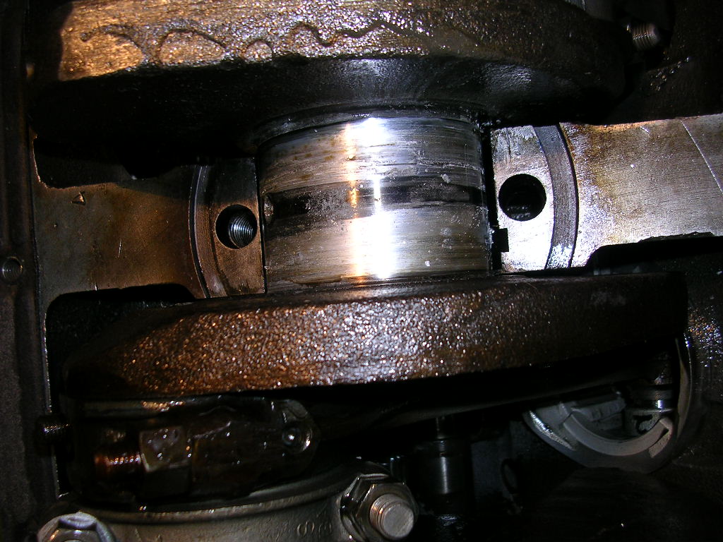

    The answer is Main bearing: the rear bearing was fine, the center bearing was toast and the front bearing was about to go.
  22. pwschuh
    Joined: Oct 27, 2008
    Posts: 2,973
    pwschuh
    That shoulda left some traces in the oil...
  23. Merc cruzer
    Joined: Feb 26, 2009
    Posts: 286
    Merc cruzer
    from Colorado
    Bottom of the pan had some, not much...looks like most stayed in the bearing and cap.
