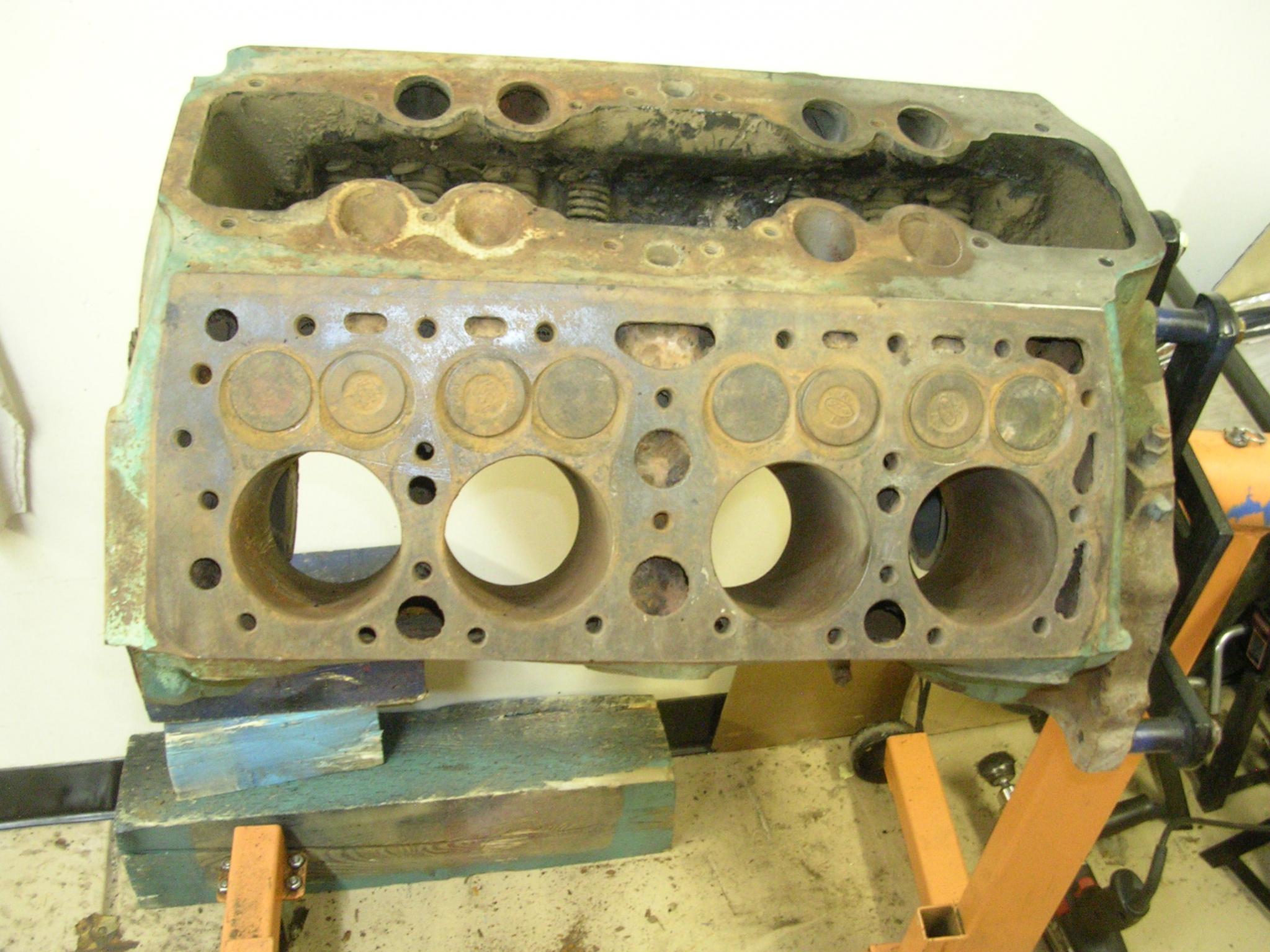

    Amen to that. The inside of a fresh rebuild should look surgically clean. It is apparent that whoever did final ***embly left a lot of machining trash in oil p***ages etc.
    BTW -- did you check out the very easily visible crack between a water p***age and a stud hole on the deck surface? Is this your "new block" or the cracked one?

    Regarding the comment on deck cracks- I'm not seeing a pic of the deck surface, but as for cracks between coolant holes and head bolt holes on a flathead Ford block, they're so common they should have part numbers. 95% of them are absolutely nothing to worry about.

    How did I miss that? Anyway, that particular spot is a very common crack in these old blocks. Most of these coolant hole-to-bolt hole cracks occured early in life, again nothing to be concerned over. I will usually helicoil these bolt holes for some added strength when torquing the bolts. Otherwise, not a problem.

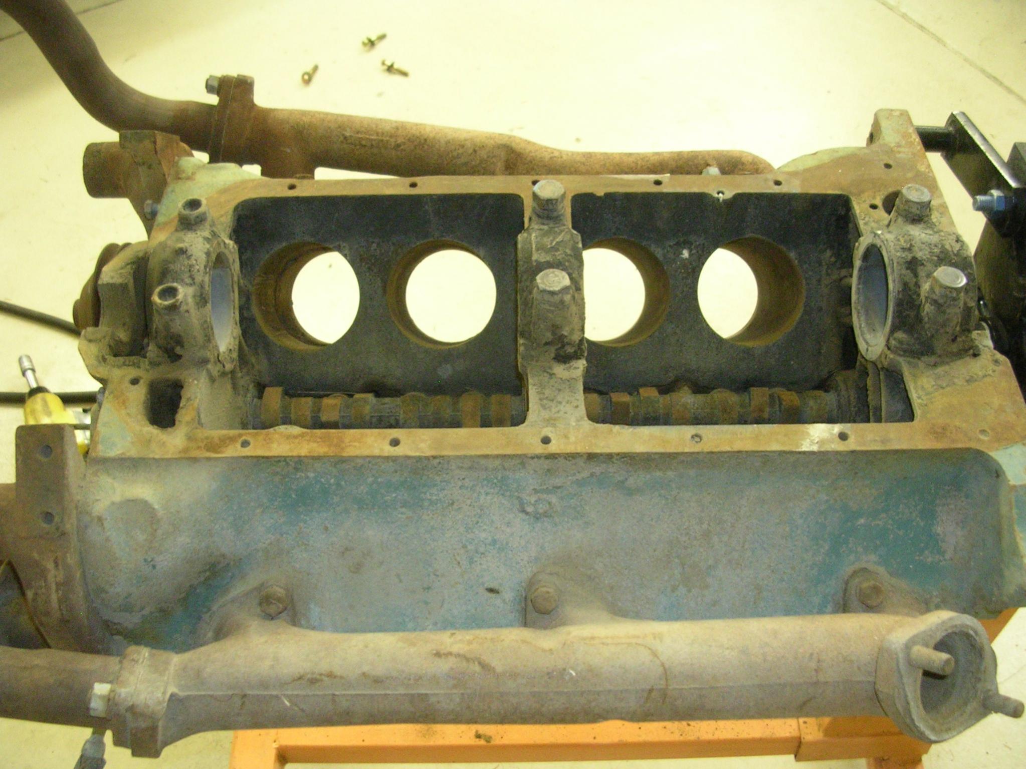

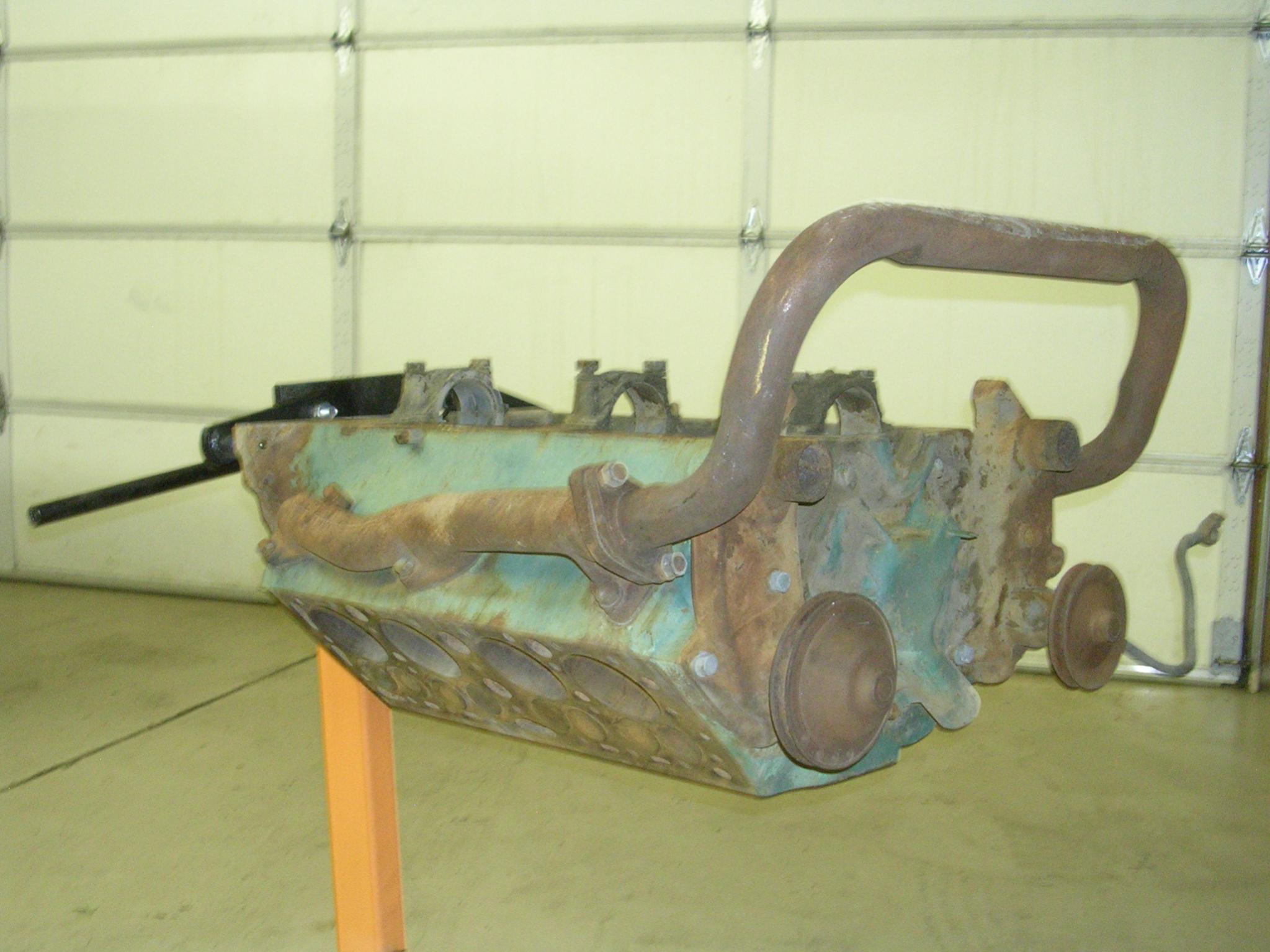

    That picture was the old block with the heads off.....before I dissembled it<?xml:namespace prefix = o ns = "urn:schemas-microsoft-com:eek:ffice:eek:ffice" /><o:p></o:p>

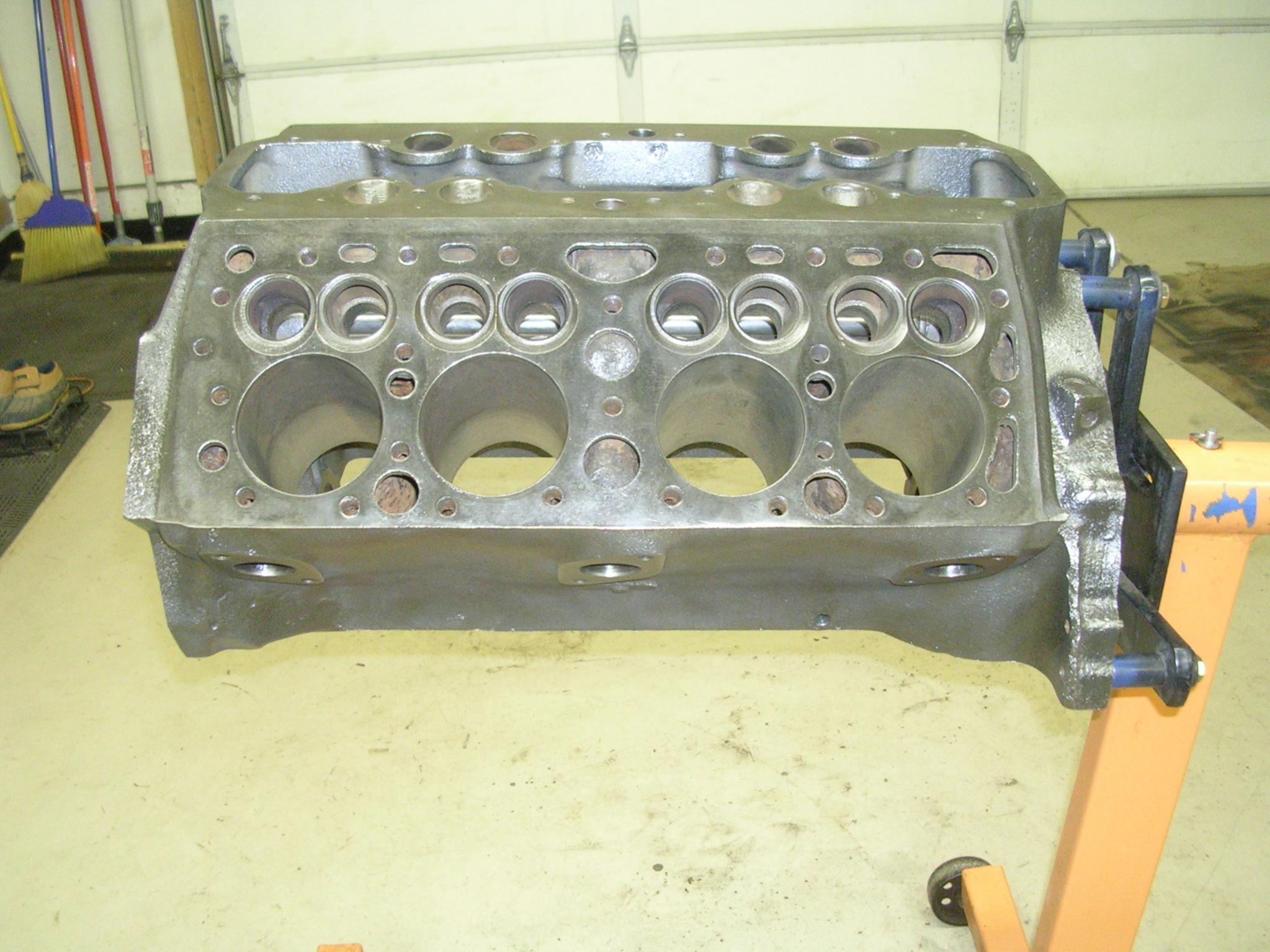

    This is the block just before I took it in to be magnafluxed

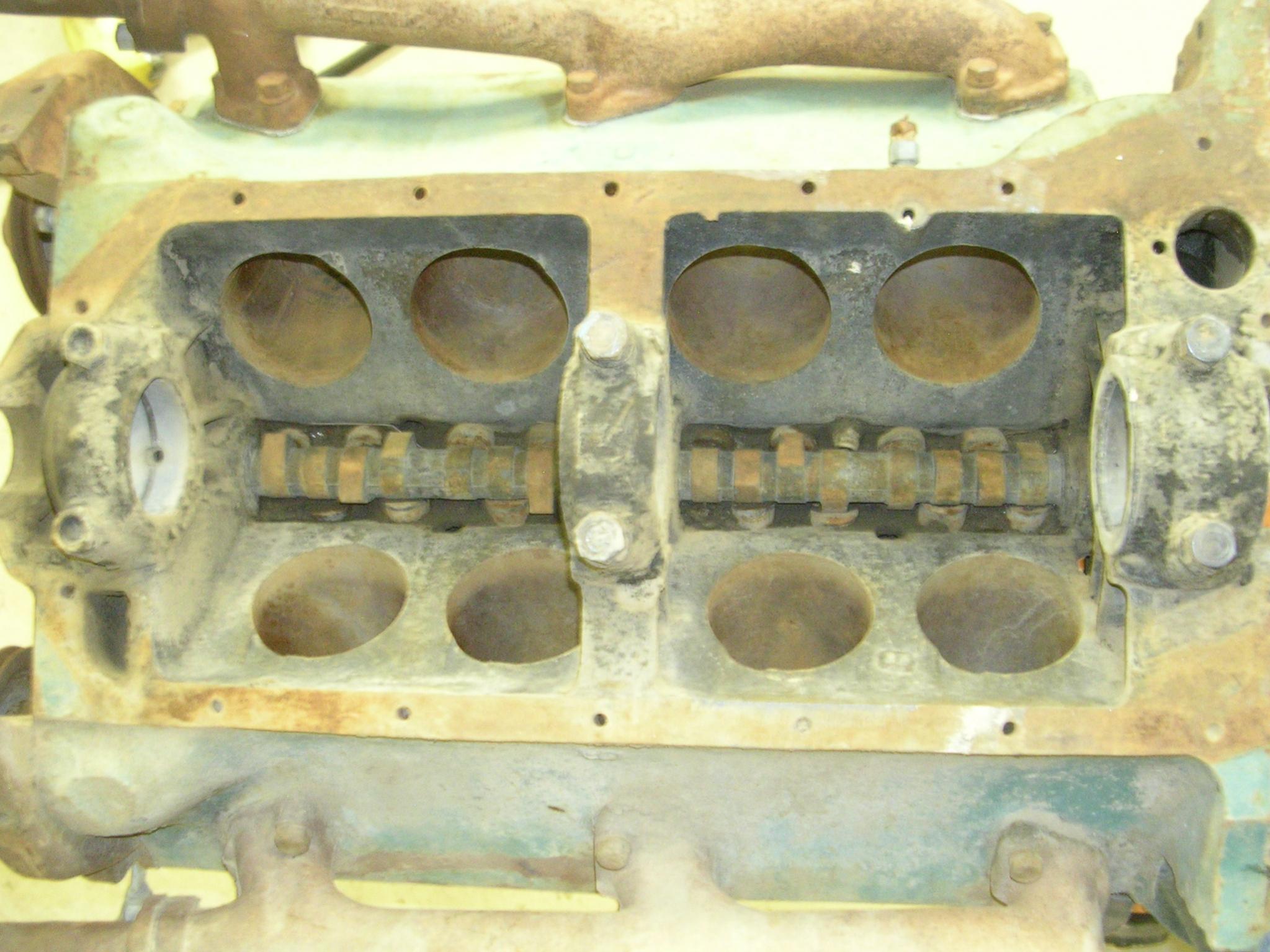

    Here is the engine when I got it from the salvage yard. Not sure if the machine shop miked the bores. The bearing tangs did match up. Thank you for the oil primer suggestion..I will do that. I wish it had been covered here before I started the engine rebuild. I tried to ask and read about everything I could before I started. This is my first flathead but not my first engine.....Porsche, Jags, MG's & Triumphs before...never with an issue.

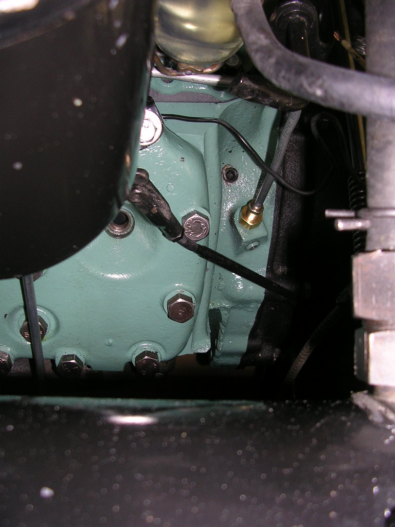

    In your ford barn post you mention that the block has been drilled for a 95% filter. Not according to your pictures in this posting or at least not completed.If it was only half done they may have put the grub screw in the horizontal p***age and it was missed this would lead to the two mains starving for oil as the rear main is oiled independently from those two.Look in horizontal oil gallery for the offending grub screw.

    That was an early picture....here is a current one...

    That's better now.Remove the allen plug from the horizontal p***age the one that has some green paint on it closest to your external oil line insert a piece of coat hanger it should go in as far or further than the other allen plug that has been put in the horizontal hole that was drilled and tapped.
    This will confirm that the grub screw is not i there If doesn't go that far the plug is in there and has starved the rest of the engine. You could pressureize the oil port with a pre lube system and confirm oil to the rest of the engine but report back first on the grub screw.
