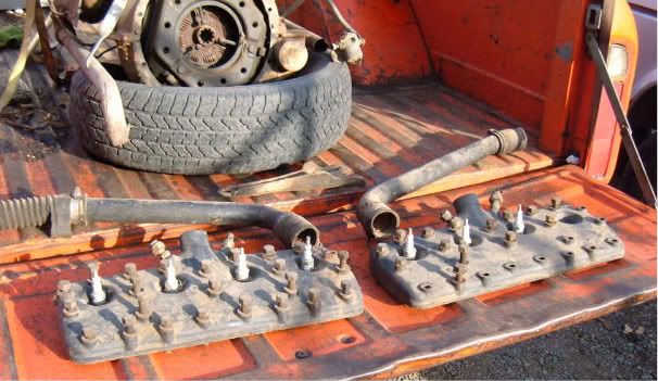

  17. Johnny Gee
    Joined: Dec 3, 2009
    Posts: 14,998
    Johnny Gee
    from Downey, Ca
