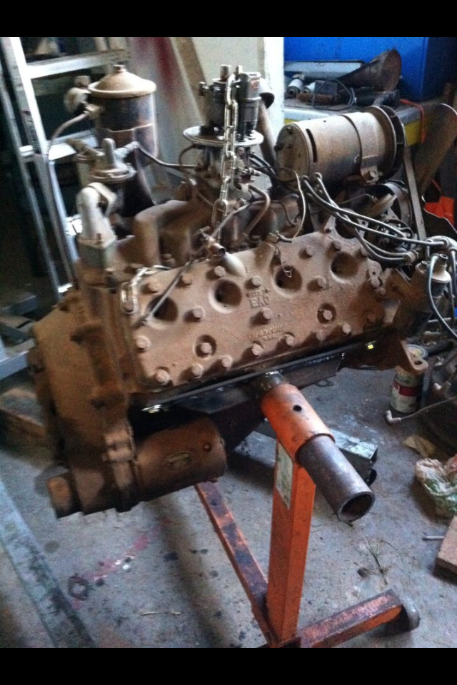

    I saw a Old KR Wilson at a swap meet Saturday. Man those are cool. If you're just looking for a mount to hang an engine off of the exhaust ports on a regular engine stand they are real easy to make. I made this one using a piece of 4 inch flat strap 1/4 thick and a piece of pipe. Works real good. This engine has been hanging off of it for over two years. ImageUploadedByH.A.M.B.1430272323.434896.jpg
