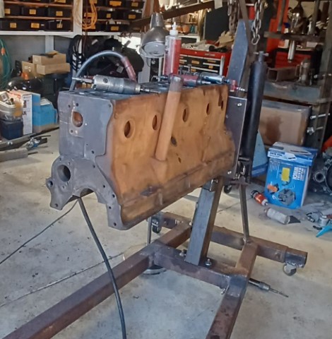

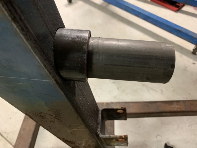

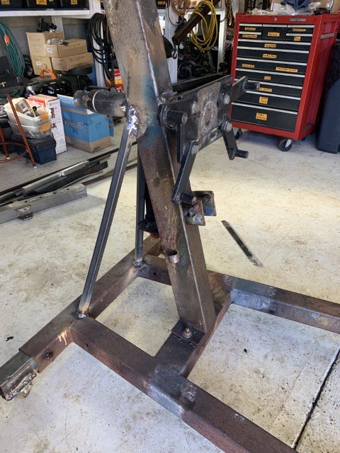

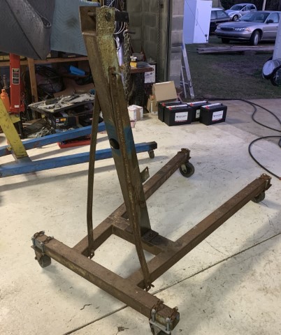

    I needed an engine stand for a Pontiac straight eight that I am building and didn't feel a standard engine stand would hold it up without sagging too much. I decided to build one that would be stout enough to hold the weight. Finding a $50 hoist that had bent legs and no ram, I straightened the legs with a floor jack and chain and turned it into an engine stand. The hoist is still functional when the engine head is removed. The DOM tubing, 2-1/2" x 1/8" and 2-1/4" x 1/4", was $1.25 a pound at the metal surplus outlet. I cut the 2-1/2" at 12inches and the 2-1/4" at 18inches. Cutting the 2-1/2" hole in the stand with the diamond cutter was a major chore. I used an engine stand head from a harbor freight stand. The head inside diameter was just over 2-1/4" so the DOM 2-1/4" x 1/4" fit inside and I welded them together. I'm not much of a welder but it's strong and it works. A 12" x 16" x 1/2" plate was bolted to the back of the engine and the head was bolted to the plate. I intended to use a hanging turnbuckle at the front of the engine for extra support but it doesn't seem to be needed. 01 dom Tubing.JPG 02 diamond blade cutter.JPG 03 cut hole.JPG 04 $50 engine stand.JPG 04.5 bent legs.JPG 05 test fit tubing.JPG 06 test fit tubing.JPG 07 test fit tubing.JPG 08 test fit tubing.JPG 09 crappy welding.JPG 10 crappy welding.JPG 11 engine stand (10).JPG 12 bellhousing.JPG 13 bellhousing engine plate.JPG 14 block plate mounted.JPG 15 engine stand.JPG 16 engine stand.JPG
