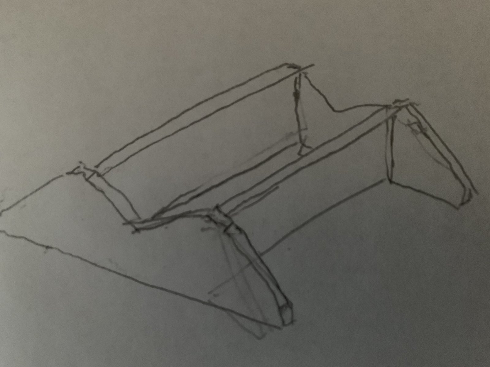

  4. squirrel
    Joined: Sep 23, 2004
    Posts: 60,336
    squirrel
    just kind of difficult to bolt the Ford engine to it.
    I've made them out of s**** lumber too....supports the oil pan rail. A few pieces of 2x8 or 2x10 lumber, one under each rail, and something across both ends, is all you need.
  5. Andy
    Joined: Nov 17, 2002
    Posts: 5,411
    Andy
