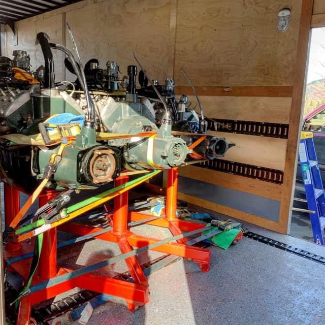

  12. The only way I will transport an engine is if it is fastened to a pallet or skid or crated for pick up - then loaded & unloaded by a forklift or other piece of equipment.
    A Tim McMaster Custom Build that I hauled from California to Texas recently …
    Jim
  13. Engine stands are engineered - designed - intended to be a static point to work on or display an engine.
    They are not suitable to hold an engine in place for transport - the center of gravity is too high.
    I transported four EFV-8 Display Engines on
    custom designed & built stands last year
    from Oregon to Indiana.
    Three were from the Edward Towe Collection that last sold many years ago.
    That load was a pain in the @ss - never again
    will I transport any engine on a stand.
    Jim
    tractorguy likes this.
