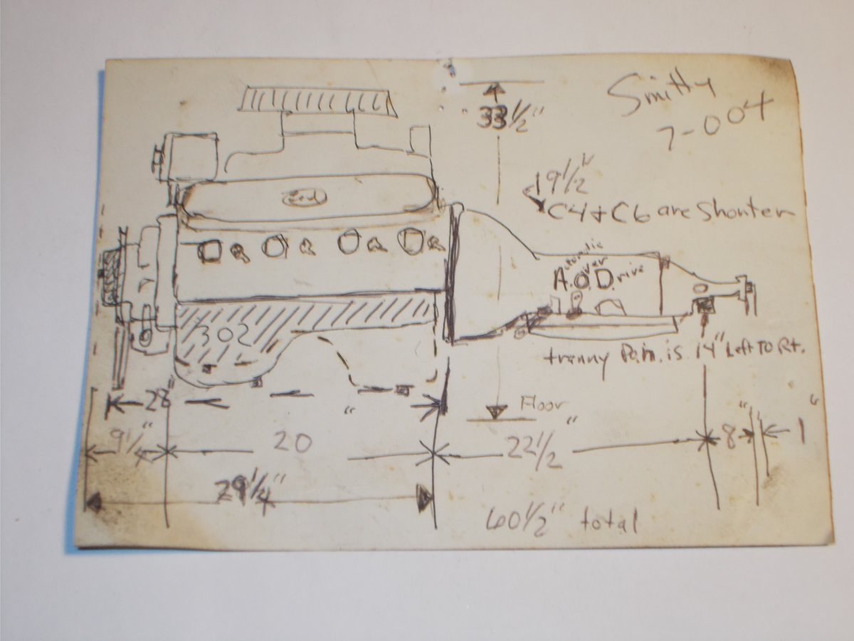

    Thanks for the pic and measurements. I do plan to use the stock 47 standard shift transmission.
