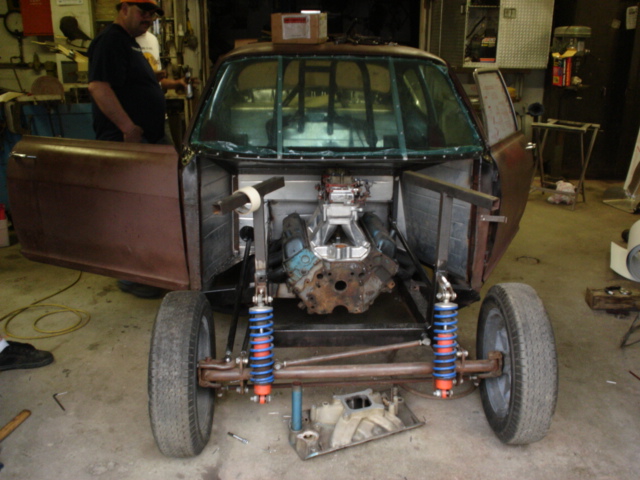

  27. sammyg
    Joined: Dec 30, 2007
    Posts: 183
    sammyg
    Guess I'll post this up and show you guys the progress and where I stand... Just need to do fuel, clutch, and brake lines, steering linkage, steering box, electrical, radiator hoses, and shift covers.
    Ended up with 1" clearance between the mechanical fan and mustang radiator. Should be clear enough.
