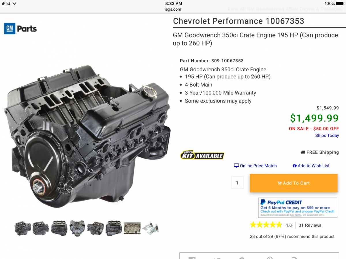

    Hello all,
    Im going to be excommunicated from my Ford sites so Im coming here for help.
    I want to put a 350/TH350 in my 64 F100. Im keeping the straight axle and the 9in rear end.
    I think I can figure out the engine / ****** mounts but I will need help with figuring out how to shift the ****** with my oem column shifter, if that is even possible. and how to mate the driveshaft to the ******.
    I plan on a 190hp Goodwrench 350 from Jegs. This is a cruiser and I dont want the headaches of a 700R4 so the TH350 is fine for my desires.
    My last SBC was a 350 in a 75 Monza, that was over 30 years ago, so Im a bit rusty on what works with what.
    I will also need help on how to configure the accessory drive system, for now all I need is the alt, but want ps and ac at a later date. I seem to remember that the alt can be mounted on either side and an issue with which wp to use.
    As we get older there is more **** to remember, Ive been killing brain cells for 40 years, so my capacity to remember anything beyond my name, rank and serial number has diminished over the years.

    Im perfectly happy with a 190hp belly ****on. A 1964 292 doesnt make anywhere near 190 hp, especially one that is 50 years old. The COM is tired and leaks like Wikileaks. My plan is disc brakes, 350/350, rebuild the 9in, toyota ps or R&P and be in under 5k. Zero rust anywhere, including the cowl, inside the doors and undercarriage, decent paint and interior, Its easy to say drop in a 302, 351, 390, its another issue sourcing these engines/brackets/pulleys 20+ years after Ford quit making them.

    I retired at age 50. I am happy to spend 5k on this project and have a low maintenance and reliable 53 year old truck that starts every time I turn the key. With two cars, two trucks, and two motorcycles, I spend enough time and money maintaining and fixing things.

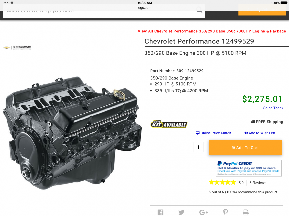

    He probably means the 290hp 350cubic inch crate motor.
