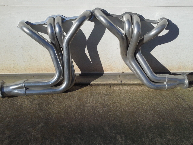

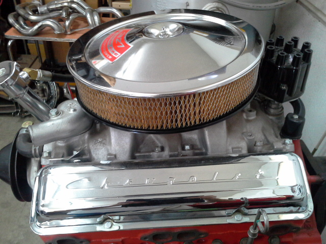

    Andy, I built this engine over 30 years ago for my long term Nova project, it's still on the stand and never fired. I do have the original Nova rams horns but also have this set of highly modified 1&3/4" headers for it, they really are a little big for an L79 but thought maybe down the road I might get more serious with more cubic inches.
    As originally mfg.
    Well, this is the only other photo I have of them.
    Deuces and Truckdoctor Andy like this.
  14. That’s a gorgeous engine, there is something so cool and pure looking about a 327! I love those valve covers too
