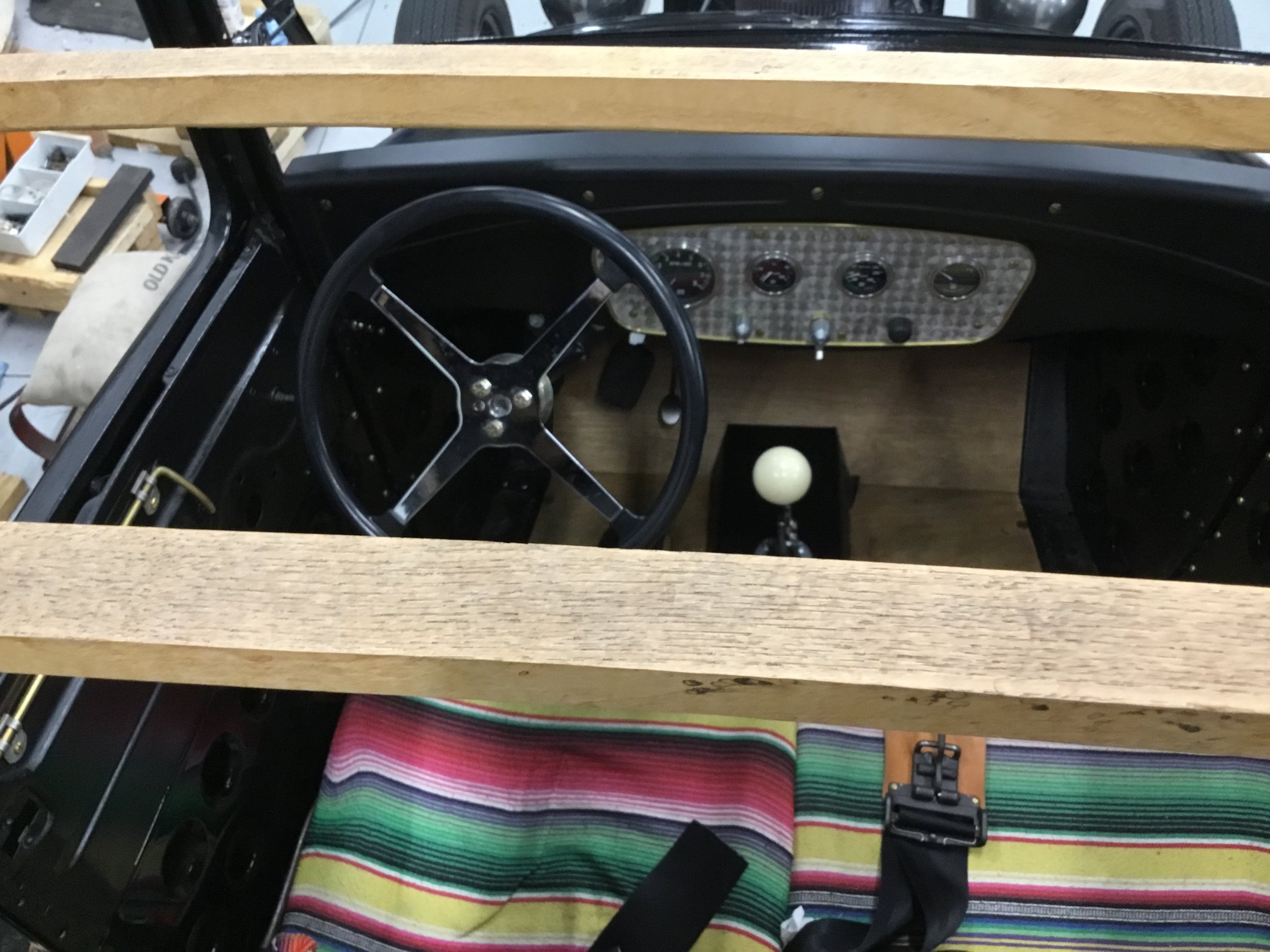

    Ok fellas, I have been driving my 30 model A Ford coupe, and I ran across a little issue. My car does not have a roof insert, and the sun reflecting off of the 4 spoke steering wheel is blinding. Not always, but once or twice is enough to make me wanna do something about it.
    So, here is my appeal to the HAMB community: Has anyone ever engine turned chrome? The instrument panel I made for it is engine turned, and I’m thinking that engine turning the steering wheel would both look right, and fix my issue. IMG_1031.jpeg IMG_1030.jpeg IMG_1031.jpeg IMG_1030.jpeg IMG_1030.jpeg IMG_1030.jpeg

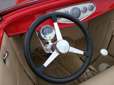

    With that being said I put this engine turned vinyl, in my top less t-bucket, on this gauge panel 20 yrs ago and it's still holding up great.

    Thanks for all the replies fellas! I’m gonna try to engine turn the underside. If it doesn’t work, I will figure something else out, paint maybe?
    I think I will use a small tool. I used 1” diameter on the dash panel. I will try a 5/8” dia tool because the spokes are so damn narrow. I would like to have at least 3 or 4 swirls in the across direction.

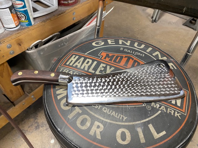

    I have. It will require the course Cratex like you would use on stainless steel. It won't bite in like aluminum but the pattern will be quite vibrant still. This is a cleaver that I "hot rod restored" (new rosewood scales, welded on a new handle with hooked end, re-profiled the blade) for a friend. It is hardened steel, not an easy surface to cut into. The pattern is still deep though. I used course Cratex and left it on the surface for at least 2 seconds where I typically would be down around 1 second on softer metal. I like masking the edges of odd items like spokes and this cleaver with duct tape around the edges to give it a border rather than run the pattern off the piece. I think that would look nice on your spokes.

    Thank you,Sir! That is super helpful (Cleaver turned out pretty sweet too BTW).
    When you use the duct tape, do you use a masking tape layer first? Or just go straight to duct tape and deal with the adhesive residue?

    I have used masking tape alone but the Cratex cuts right through. Here is a picture of a trophy I built earlier this year for upcoming Lloydfest III.
    I apply the duct tape directly but your idea of lining it first with masking tape is clever. The only issue I see is the thickness of the tape will affect the pattern on the edge.
    I remove the tape, clean with whatever solvent is at hand and then I run the edge on the buffer lightly to polish it. You will have to be creative working on those spokes and leave out the polish step. I think it is much cooler leaving a border than running the pattern off the sides. This the is the panel turned and cleaned up.
    And a close up of that tricky bit at the bottom. As you can see, I like to round off the sharp edge of the panel to create a "softer" feel. I like that about polished metal, the way it feels in your fingers. You can't do that with a chromed surface as it will peel.
    This panel was done entirely using 3M masking tape to protect the edge and give me a place to work my pattern. You can see a very slight difference in thickness of the border from side to side. You can also see the "looseness" of my pattern on the right compared to the left, I was stretching the pattern to fill the panel and slightly overdid it. You can measure all you want but engine turning comes down to touch and feel. It is art not just maths. Imperfection is part of the beauty IMO. In the examples above of the vinyl, they are perfect and very nice.
    You can see I used a full circle around the boarder, rather than filling the pattern with a half circle which I would have preferred If I was to be picky. For that, the duct tape is the only thing I have experimented with that allows me to set the Cratex down "on the tape" and not tear it up and not be so thick as to prevent the Cratex from hitting the surface. This is just aluminum so a soft Cratex was used.
