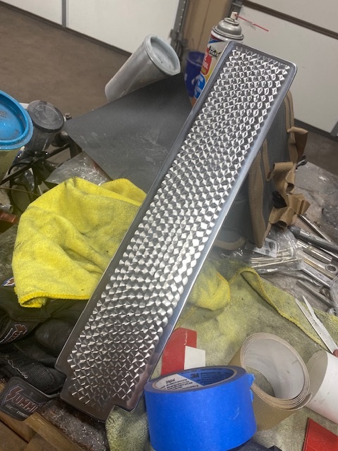

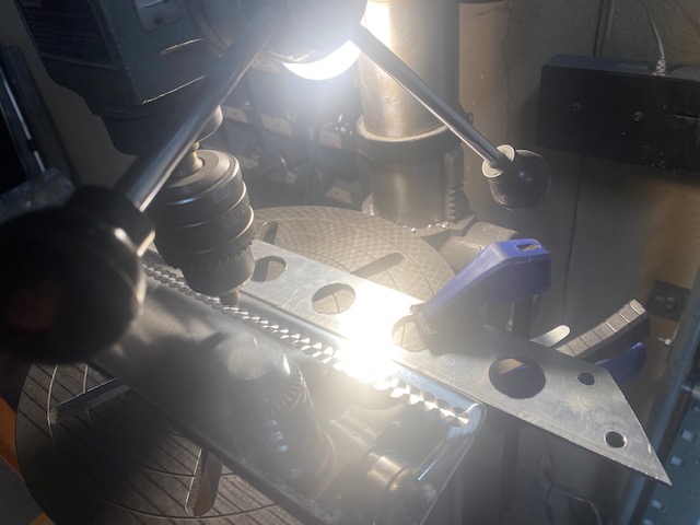

  3. Bandit Billy
    Joined: Sep 16, 2014
    Posts: 17,192
    Bandit Billy
    That's a fine compliment right there! I started doing this only a couple of years ago based on info I gleaned from the HAMB. Since then, I have done tons of projects on my cars. I'm a certified engine turned junkie! It doesn't fingerprint, it doesn't smudge, it hides imperfections and like you said, it doesn't reflect sunlight back in your face.
    I just use my drill press with a grid I laid out in sharpie, a couple of clamps and a straight edge. A mill would be nice, but I don't own one. Check this out, I did these breathers on one of my cars. I did this by holding the breather with my hands and lifting it into the Cratex spinning in the drill press. Completely by hand. You can handle this steering wheel. I look forward to seeing the results. If you mess up, just sand and polish...like a magic eraser.

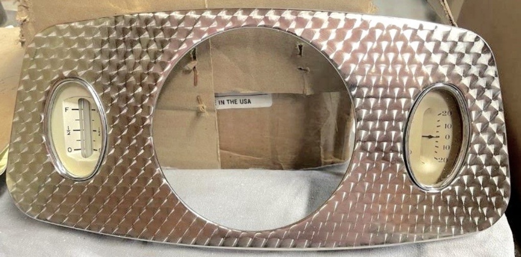

  6. Deuce Lover
    Joined: Feb 15, 2009
    Posts: 1,255
    Deuce Lover
    There is a guy in CO that does the engine turning for 32 & 33 Ford gauge panels. He requires that the panel be chromed ,then he does the engine turning.Here is a pic of the panel he did for my friend in FL.First pic is the chromed panel sent to the engine turner.
  7. patsurf
    Joined: Jan 18, 2018
    Posts: 3,391
    patsurf
    now THERE is the answer to the o.p.!!
    Kelly Burns likes this.
  8. jcrapola
    Joined: Jan 30, 2010
    Posts: 45
    jcrapola
    BOOM! That is what I was seeking. Thank you!
    Bandit Billy likes this.

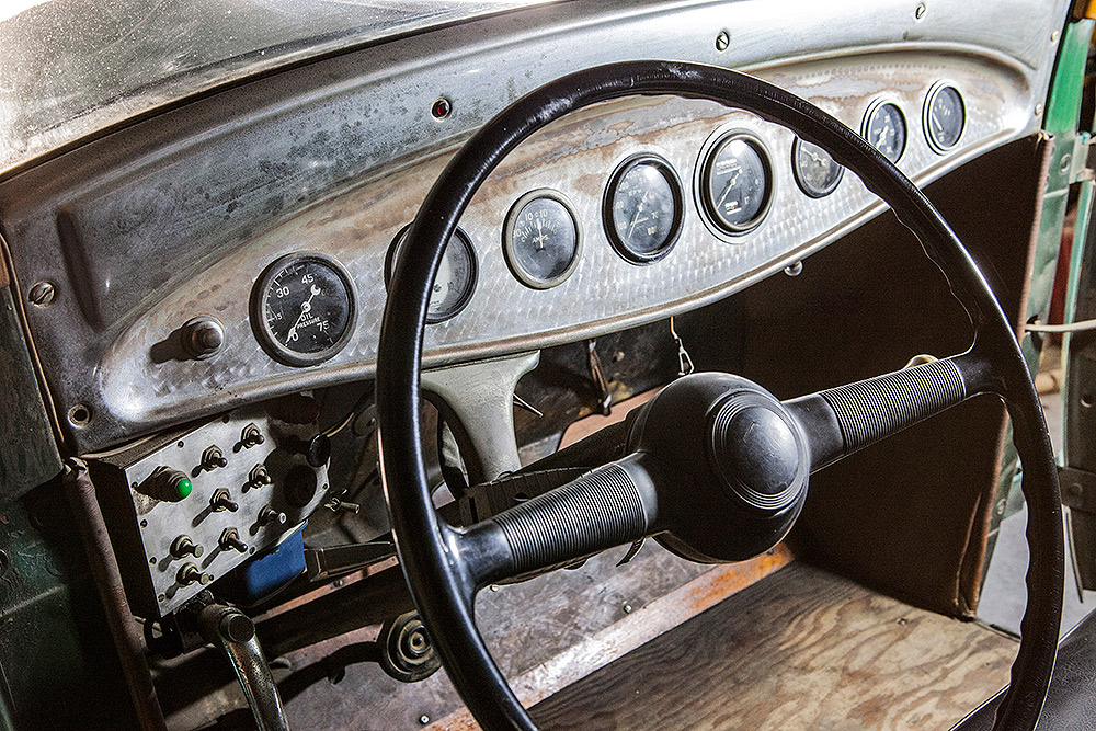

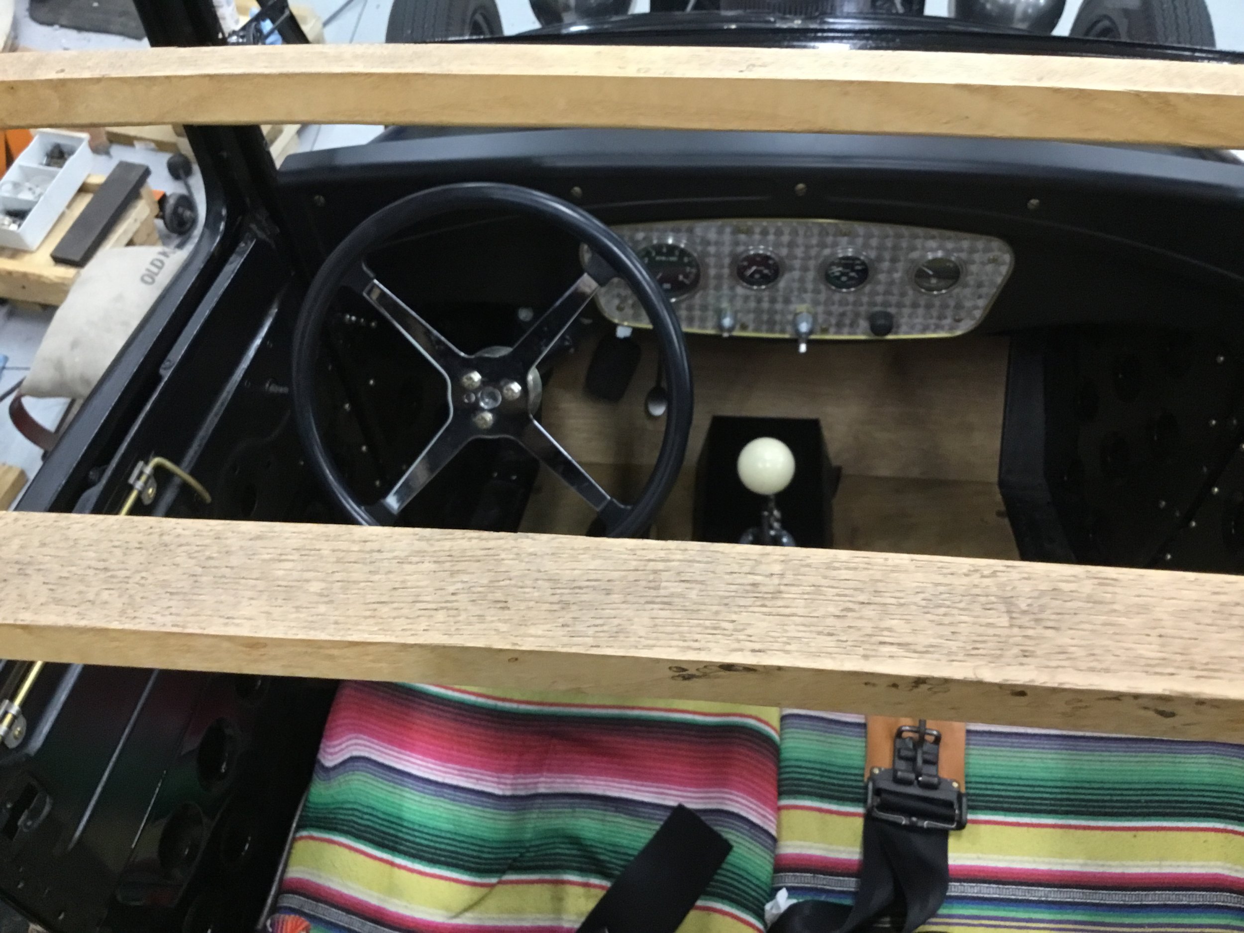

  9. crminal
    Joined: Jun 6, 2010
    Posts: 1,944
    crminal
    05snopro440 and Bandit Billy like this.
  10. jcrapola
    Posts: 45
    jcrapola
    Love that interior! Looks like it has some wonderful memories in there.
