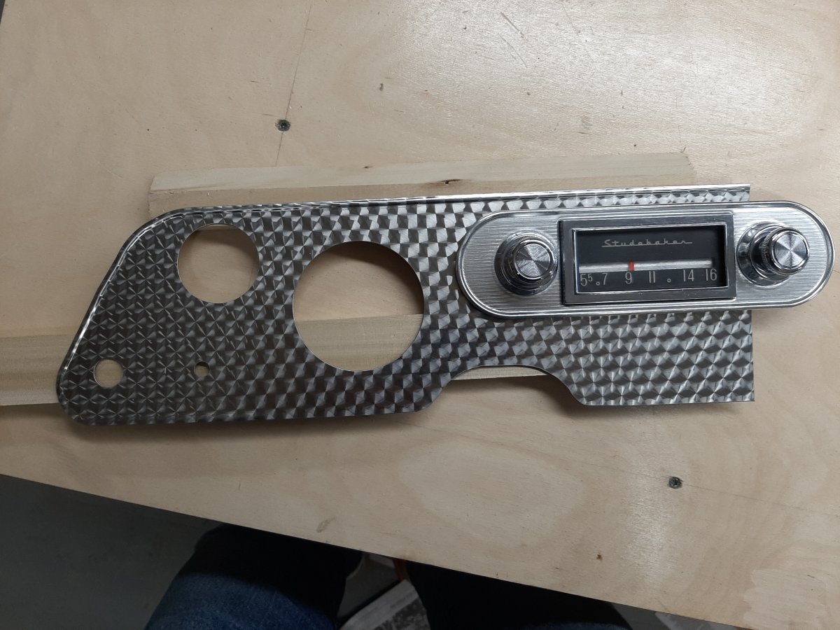

    The radio is a fake Studebaker AM radio that I will remove to have a modern radio behind it.

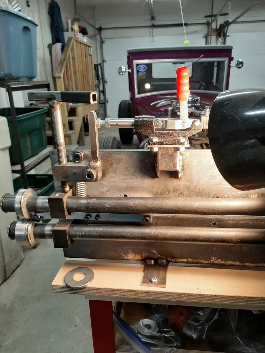

    What I had felt was the right way to go in forming a bead around the perimeter of the engine turned panel was to not do it with conventional dies, which would do the edge on the rectangular sheet and then cut it out around the edge of the bead. Instead, I wanted to form it with an edge guide that will allow both convex (easy) and concave) curves as well as the straight edges.

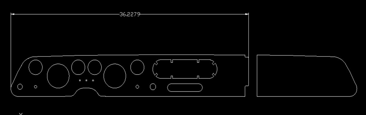

    First, I laid out the whole insert in CAD so I could have the 22 GA. polished stainless cut out for me on a waterjet system:
    Then, after talking to Jere, who suggested that I look at using ¾” flat washers for the dies. They are 2” OD and have to have the center bored to fit the HFBR shafts. At the same time, I made an arbor to fit a lathe that matched the end shaft of the HFBR so I can pop it in the lathe and make washer dies to fit any appropriate situation in the future.
    Here’s a picture of the dies as laid out in CAD. I used a small ball bearing as an edge guide so that I could follow the edge of the part for both convex and concave curves. As I was laying it out, I discovered that I had to do the edge in two stages. First with the edge guide and a flared, but not completed edge (to clear the bearing), and then a second p*** with another lower die to form the edge to lay against the dash itself:
    Here’s a picture of the completed first stage bead roller and dies:
    Note that I used aluminum for part of the die set to keep fro scratching the jewelled surface.
    I might also add that I found the gearmotor on eBay that works very well. It has a ¾” hollow shaft that required my turning and keying the HFBR shaft. It turns at 4 rpm, so I don’t need a variable speed drive. I bought a foot pedal ***embly on Amazon for reversing capabilities. It had to be rewired, but it works great. I used a 4-wire trailer plug so I could easily disconnect it, as well.
    https://www.ebay.com/itm/Bison-1-15...484688?hash=item33faa58950:g:6T0AAOSwy2pb-HO4

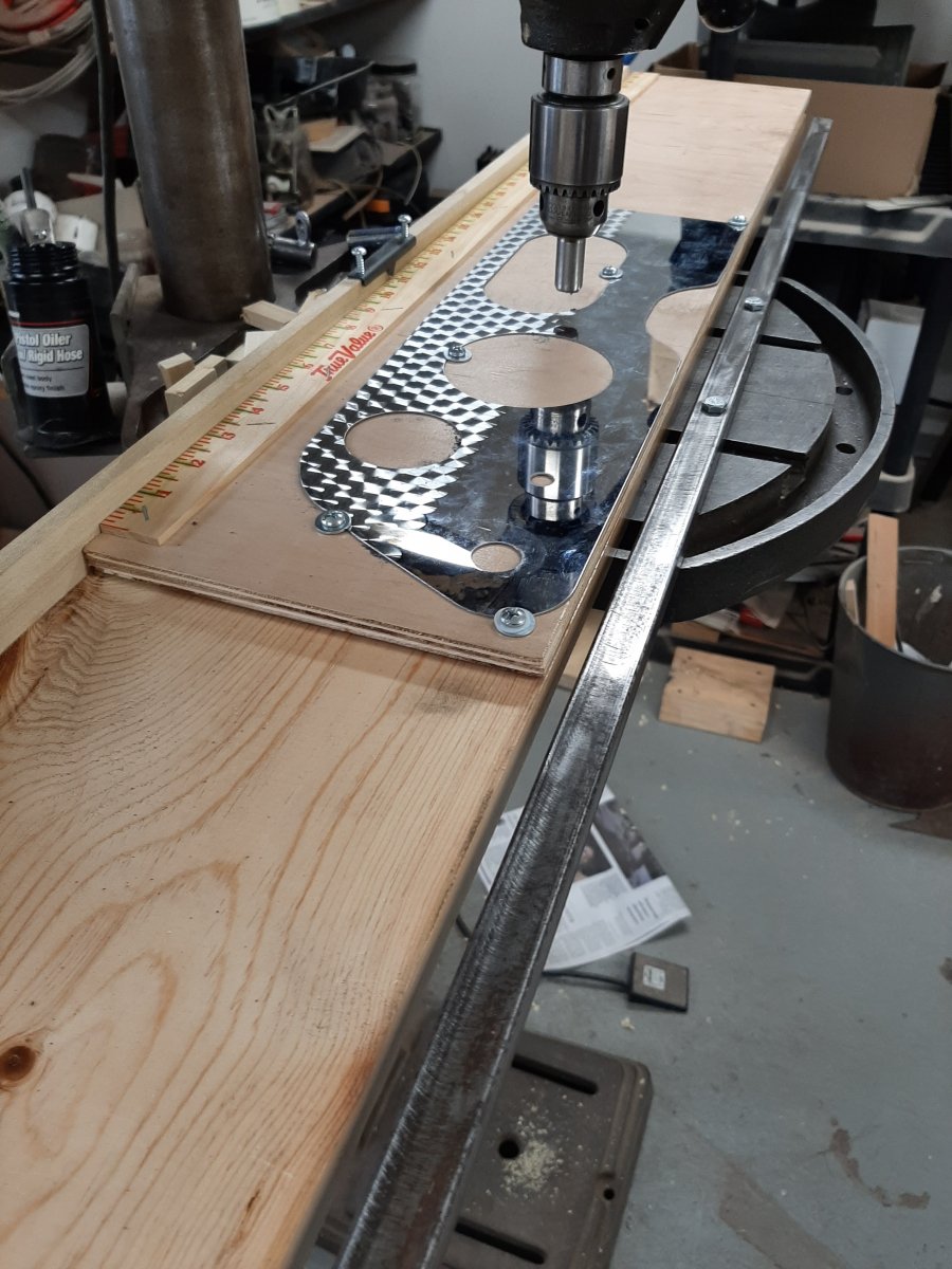

    Now for the engine turning (also called jewelling). After a lot of research as to what others have done, I settled on using ½” Cratex rods and my old Craftsman drill press, along with a sliding tray system. I had the waterjet guy cut me a test piece for the jewelling that I had drawn with CAD that combines some of the shapes on the finished part, but could be cut from a smaller piece of stainless I had (I am also having him cut some practice pieces for the edge bead rolling).
    The sliding tray system uses a stationary tray with an adjustable pointer on the far edge and a sliding tray with a yardstick for indexing sided-to-side (horizontal). I highlighted the ½” increments so I would better spot where I had to line up the increments with the pointer. Since I was using ½” increments horizontally, I needed to offset every other row ¼”, so the pointer needs to be unscrewed and moved to a spot ¼: off the primary marks, and I used the same screw holes in the pointer itself. (Note: I will probably go to a 1cm horizontal spacing for the final piece to change the appearance slightly...just have to adjust the pointer offset and turn the yardstick over :))
    The stationary tray is bolted in place on the drill press table using the clamping slots.
    A piece of square tubing is used as a register to index the stationary table front-to-back (vertical). It is bolted to the table as well and then also clamps using the same clamping slots to be relocated as needed.
    The jeweled sample piece is screwed down to the sliding table using wood screws with both flat washers and nylon washer which allow the clamping without scratching the jeweled surface. I used several clamping screws so that I could remove one or more when the screws would interfere with the jewelling.
    Here are some pictures of the setup:

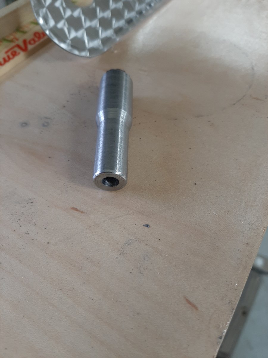

    As to the Cratex rods, I used a medium (brown) rod and no lubricant. I turned holder on a lathe that has a 1/2" diameter x 7/8" deep bore and a 1/4" hole that extends thru the 1/2" diameter shank. The 1/4" hole is to push the Cratex rod out. The bore is right at 0.500" to allow a rod to fit somewhat snugly. I thought I might have to add a set screw on the side to keep the Cratex from spinning in the hoilder, but it was not needed. As the rod wears down to the end of the holder, I push the rod out, put in small washers and re-insert the rod.

  2. This is going to turn our well. The 'test piece' looks like the way the factory should have done it. :rolleyes:

    Looks like a really good start. I used co**** Cratex on stainless here. Medium didn’t produce enough scratching for me.
    That Cratex holder is slick. Lacking a lathe, I used a piece of K&S br*** tube from the local hardware store.

    First I finished the first stage bead rolling (with the edge guide roller). Here's a closup of a problem I encountered because of my early reinforcement of the 3/8" main plate of the HFBR, where I had clamped the adjustable mounting of the guide roller holder. Unfortunately, the concave spot over where the dash and steering column meet, interfered with the aforementioned clamp:
    Luckily, it only required replacing the long bolts and clamp bars with short bolts and washer stacks:
    So I was able to complete the circuit and then changed to the second stage bottom die, which is only a single washer change and slide the guide roller out of the way:
    So I was able to do the second stage fine, which involved running the upper roller down the gutter. However, the second stage will not allow concave curves without ruining the outside edge, so at those two places, I just released the pressure and moved the piece to an area where it would not interfer. That' a really nice feature of the Jere Kirkpatrick HFBR modifications. Flipping the cam lever just releases the pressure so I can move the piece and reengage the cam lever to keep the roller pressure the same.
    Now I have the edge sitting flat on the dash surface:
    Next, I masked off the jewelled surface and buffed the edge on the buffing wheel:
    So there you have it. I am satisfied with the results enough to call the waterjet guy and cancel his cutting the bead roller practice pieces and send him the CAD file for the final pieces, although I will probably have him cut two, just to be safe.

    That wood table/ guides is genius. I’m stealing that for sure

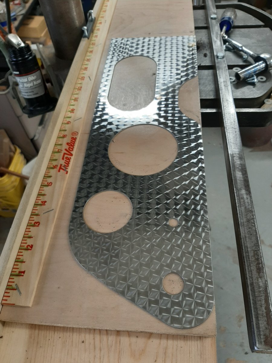

    It has come to p*** that I am back on the engine turning. It took a while to get me fixing the CAD file for the waterjet cutting of the panel on the shiney stainless panel:
    Then I decided to use 5/8" Cratex rods, so I had to make a new holder. On this one I threaded the center for a long headless 1/4" set screw. I now can advance the piece of worn down Cratex by simply turning the set screw to push it forward (previously I added small washers to shim it forward).
    Then, after de-burring the backside of the panel from the cutting, it was back to the drill press with the Cratex:

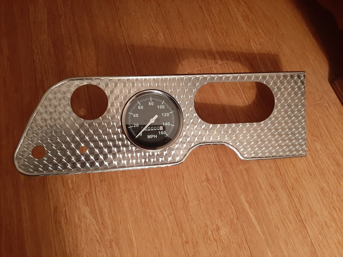

    Finished the engine turning on the panel today. The set screw in the Cratex holder worked out just fine. I did learn that occasionally I had to take a flat file and square off the end of the Cratex. This is especially an issue on the 5/8" dia. It especialy occurs when I do on an edge of a hole and it wears so that there is a protrusion at the center of the rod. It needs to be flat to do an evenly textured circle.
    Notice how the register tube starts out clamped to the drill press table. I then add 5/16" thick woood blocks to move the pointer table toward the post in incremental moves. After about 5 blocks are stacked, I remove the blocks, leaving the pointer table bolted to the drill pres table, move the register tube against the pointer table and bolt it down. Then I loosen the pointer table and start adding blocks again.
    Each line of circles is offset by 1/4", so I move the pointer back and forth each line and line up the pointer with the 1/2" increments on the yardstick. Boring job, but it gets it done. Also gotta hold the sliding board with the yardstick solidly against the backstop at the pointer. Don't want the circles to be squiggles!
    Set it in the Hawk dash, and it fits fine!
    Next is rolling the bead arond the edge.

    Bead-rolled the edge. After the boring job of engine turning, this is something one does not want to screw up!:
    Now to polish the bead and do what I gotta do to attach it to the dash (temporarily, for now).
