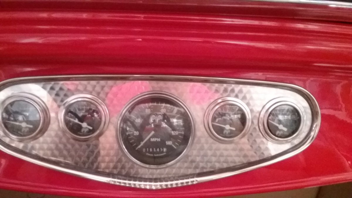

    I love the sight of engine turned panels. It creates a cl***ic look of old world craftsmanship. This is just my crummy aftermarket gauge panel in my Roadster. Show us your work or any engine turning you may have seen and couldn't resist taking a picture. Don't limit it to gauge panels.:) 20160914_152236.jpg

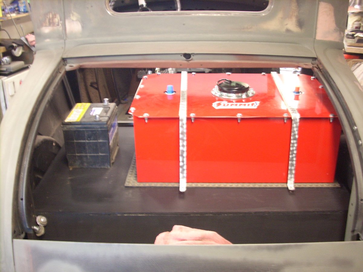

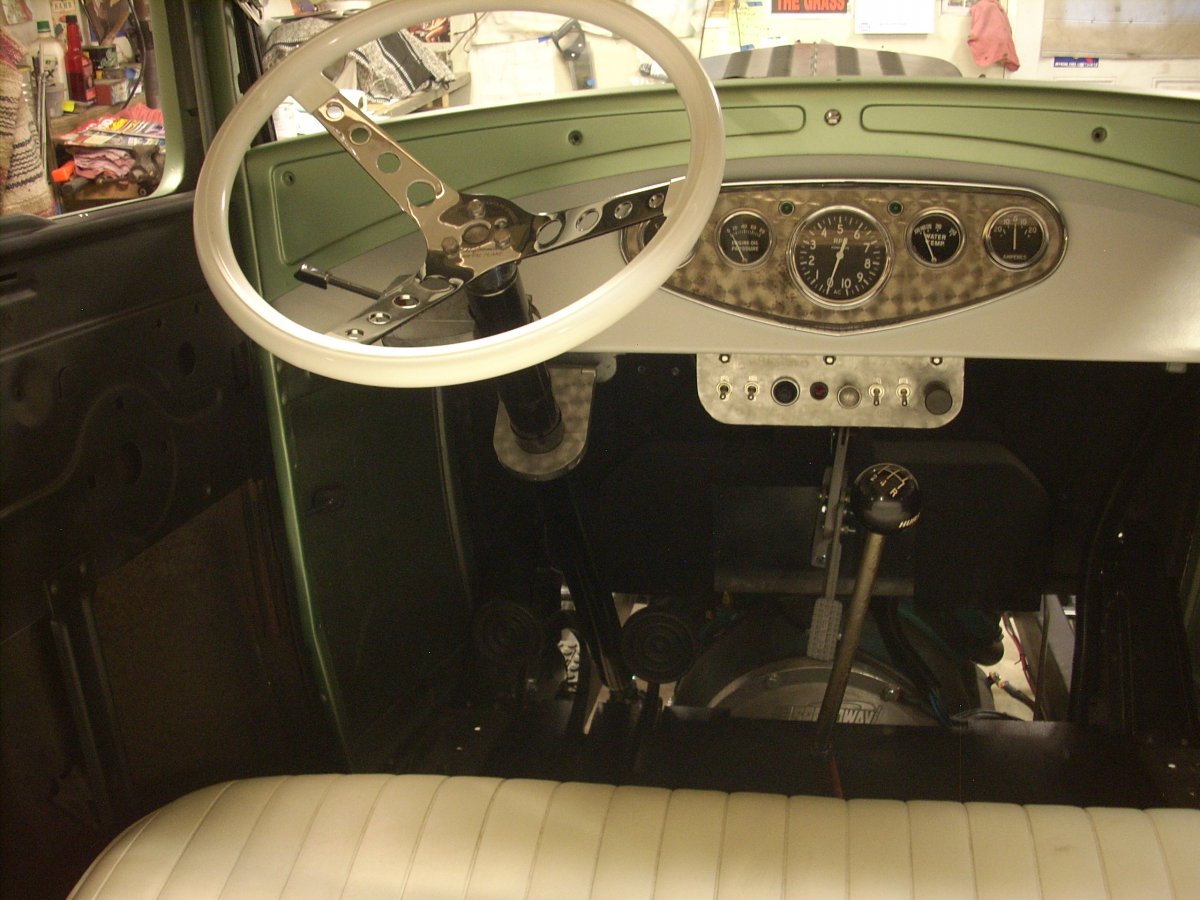

    #1- rear spring cover-'31 roadster (sold)
    #2- dash panel- '30 Tudor sedan
    #3- gas tank straps- '30 coupe-
    #4- dash panel, switch panel, and column drop - '30 coupe
    All done on a drill press - I'm a big fan of engine turning ( and louvers)
    All cars have new owners; on to the next one.

    Beautiful work, guys. Thanks for posting the pictures.
