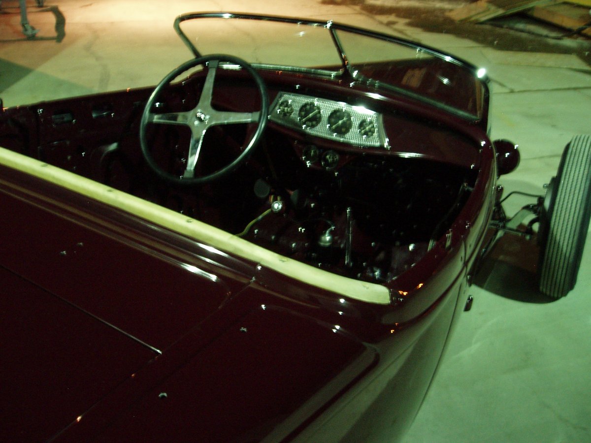

    I did this dash for my 32 five window using a abrasive round in my drill press. It's stainless and stays very fresh looking.

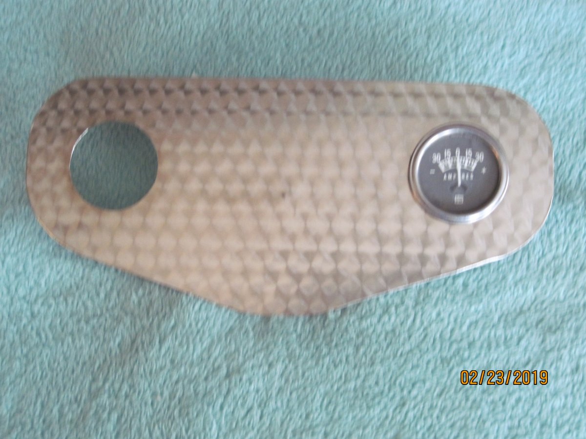

    My first attempt using a drill press and a half-inch Cratex on 16 gauge stainless steel. I still have to cut a 3-3/8 inch hole in the middle for the tachometer, and drill small holes for the turn signals, high beam and start/run indicator, but you get the idea. I needed more dash surface than my 29AA provided, so I'm making an overhead panel the length of the front header, where I can also put a light switch, a radio and some speakers. Dang that stainless is tough to cut a hole through.
