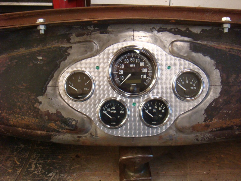

    Here is mine. 1/4" aluminum a friend cut out on his plasma table. Used a 7/8 dia. alum impregnated rubber tool on a 5/16" grid on my drill press.
    Edit:I made a grid of 5/16" squares on a piece of 3/4" plywood, (think graph paper) and mounted it to my drill press table. Mounted the gauge panel to a rectangle piece of 3/4" plywood so I could follow the grid. Started on the left side of the panel. pull the tool down hold for a few seconds, move a square, repeat Do a line, go back to start square, move down a square, repeat.

  3. Thanks for the tip on carbide provider, David. This dash is terrific! I like the blue indicators.
