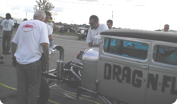

    Tearing down the Fly to find the ever ellusive "Gremlin". Upon disassembly we found a couple of pistons that have had an ever so slight "kiss". The top of the piston has just grazed a valve. This is evident in 3 cylinders. When I say grazed, it barely polished the carbon off the pistons.
    Now I understand we have an evident problem but here is my actual question.
    Would or could this cause the stutter that I had upon launch?
    The stutter would appear after 60 feet or so for approx. 1 second then run like gangbusters. We changed every component known to man and still no change. Could this be our problem?
    The mystery cam that has been in the car from the beginning is going away to try and alleviate any unknowns.

  30. Rooter.....I ain't got a clue but I love watching you and yer dad work on it.
