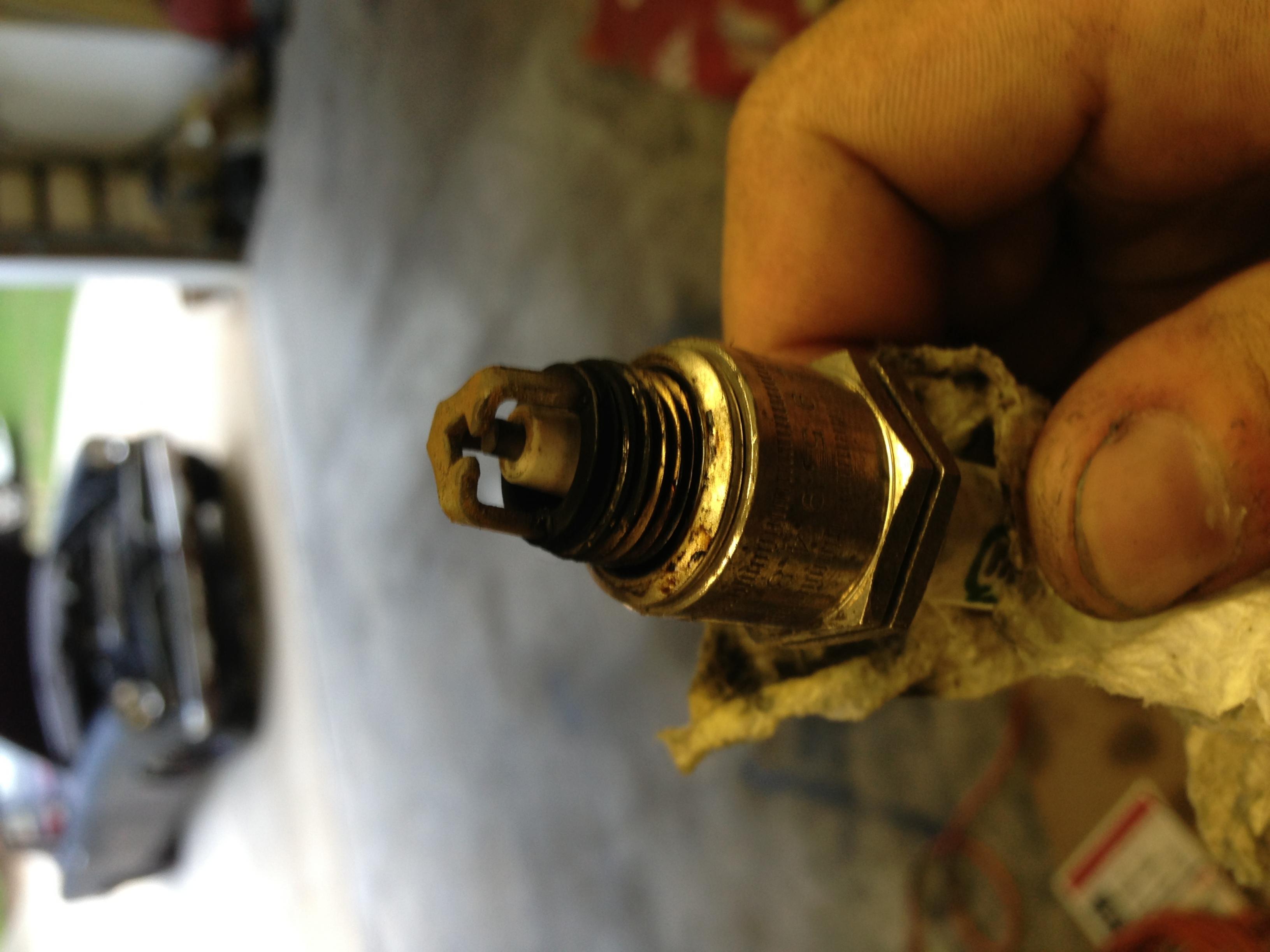

I have a 383 that I rebuilt last year it has flat top pistons and a 268 cam topped with a weiand dual plane and an edelbrock 1407 and a set of hooker fenderwell headers. Before the rebuild it was a stock 2 barrel 68 short block with the stock heads and mentions bolt-ons and would run great all the way up to 5,500. Now after the rebuild it loses power and bogs above 3,500 rpm and seems like it misses too. I have the base timing set at 13 degrees and the dizzy is stock with a pertronix electronic ignition. I pulled two plugs and they look good and the cylinder pressure in those cylinders is 130 psi. This car starts right up and idles good and drives good around town but when the hammer is down or above 3,500 it misses and stumbles. I can't hear or feel any pinging.
