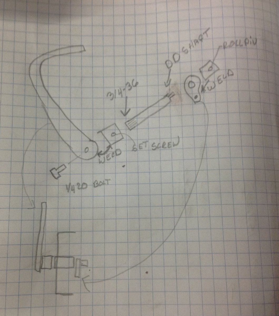

  1. I have a situation where I need to build an off set brake pedal, about 3".
    It needs to have the ability be ***embled on either side and come apart too.
    The 3/4 shaft will ride on Oilites in a DOM tube welded thru the frame rail.
    My question is on the torsional strength of the shaft ends and couplings being used in a critical connection in a brake pedal.
    The couplings proposed are high quality common steering shaft units - 1.25 OD with 0.250 wall. Splined ends 3/4-36 and the other will be 3/4-DD. These couplings will be welded to the pedal end and master cyl pushrod link end..
    I tried looking the information up and could not find what I was expecting, a simple torque load rating on a shaft with those ends.
    I found some information but I clearly do not understand how to interpret it at all.
    I figure the torque on the shaft to be normally 100 ft lbs. and an estimated 500 ft lbs in a shock load panic stop. I don't know if the 3/4 shaft and those ends can take that so I'm asking for help, advice, or a direction on where to look for what I need.

    My only real worry with the diagram you provided is the roll pin. In this arrangement, the roll pin is the weak link due to shear. If you could utilize a double-set screw connection on the DD end, I would be less worried. And if you could find a female DD coupling, that would be optimal (obviously with a set screw as well).
    The steering shaft material should be plenty strong enough to handle the torsional load, but as Squirrel said, it wont hurt to ask Borgeson or others that supply these components.

  8. ^^Yep^^
    The shaft is solid and DD on the master cylinder end and 3/4-36 on the pedal end.

    I honestly believe you have a solid looking setup,the DD shaft is designed for steering and can handle the forces,have you thought of using a longer set screw instead of the roll pin? HRP

    But bonzo is right those splined shafts are more than up to the task, it's those DD ends I don't like, if for no other reason than they are ugly, hate those shafts with the full length flats, the only reason the aftermarket adopted them is the ease of mfg and ***embly.
    I'd be more concerned about the stress riser issue with the sharp corners on the DD flats if it is to be cut with a standard end mill.
    Why not make both ends splined, unless I've missed something there should be no difference ***embly wise.
    Not that they are lending any overall strength but I think the retaining bolts could be at least 5/16", it would be awful easy to overtighten a 1/4" bolt.
    May need to give more detailed drawing but I just don't see why that won't work.

    The torsional load is taken buy the DD and the roll pin is just to hold posission?? If the fitment snug on the DD, there is no issue, but would not use a roll pin if the fitment is a little loose. instead use a ream for the hole and a AN bolt. AN bolts, the shank is more presise then a hardware store bought bolt
  25. Find a company around you that does equipment engineering.forklifts man lifts repairs etc or a fabrication shop that deals with these repairs and modifications
    Show them your drawing and ask them.
    They would know 100%
    Nice thing as well considering it’s brakes and a critical component they could sign off on the engineering tag it and stamp it with an engineering number so everyone knows it’s safe and will perform in fatigue stress and extreme situations
    You would be surprised what they charge, use them at work a lot and if it’s a straight forward meeting, see the drawings, sign off or make adjustments then a visit to inspect the finished parts they have done it for less then $200 bucks
    I can get you in contact with a few reputable companies that I deal with but your kind of far away.

    Your shaft and joint design exceeds this, to be able withstand full leg power and shock force. As long as the pedal arm will support the proposed force, theres no concern.
