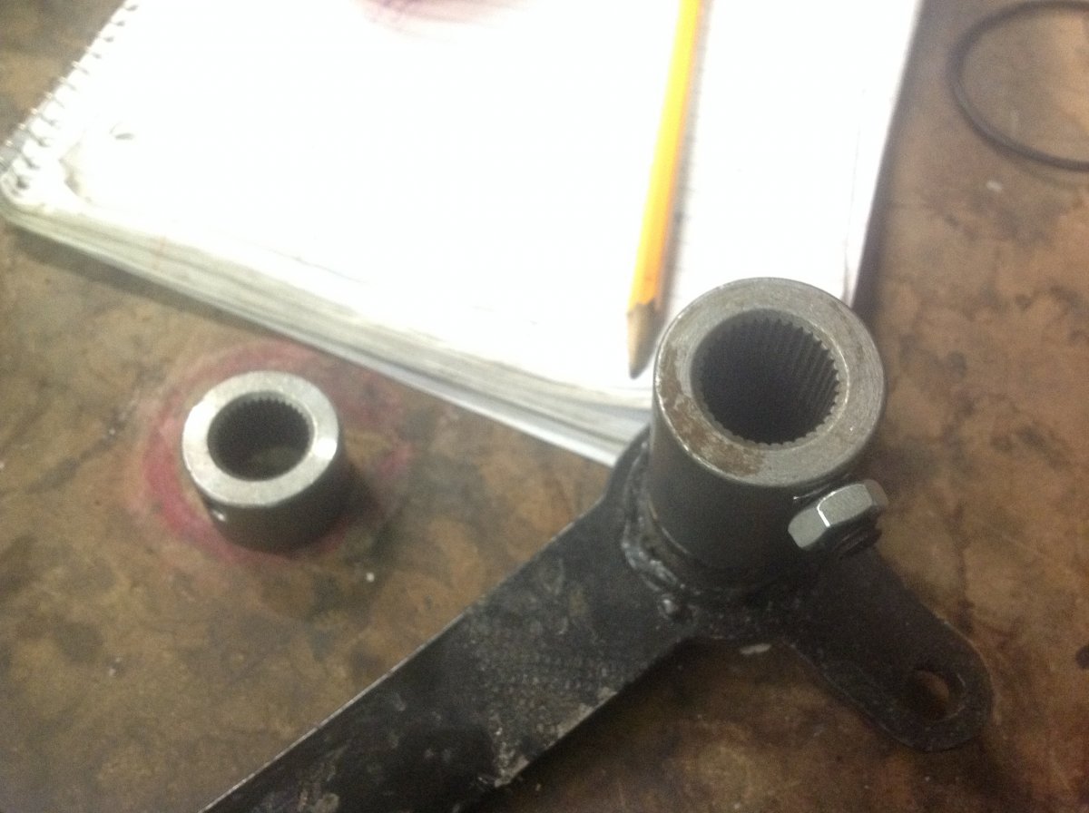

    Just for clarity:
    The flat plate brake pedals (most) have a 1"-1/4 X 0.125 wall tube welded into them, they ride on bronze bushings that pivot on a 3/4" pin. That pin serves its duty in shear orientation. Usually the 3/4 pin has its primary attachment on a weldment bracket and there is a secondary bracket that braces off the pin's end creating a double shear.
    I don't see the weld on the pedal bracket as critical, the welds on the pivot pin would be more so
    I'd trust this weld to hold the tube where it's at, but not much more. All that wels has to do is hold the tube, it's not involved with stopping the vehicle at all. If it should fail the pedal will wiggle around long before the pedal lost its connection to the master cylinder.

  7. With the coupling welded to the pedal, my welds would be critical, the coupling connections to the shaft critical, and the shaft critical. The pivot tube for the shaft would be much less critical

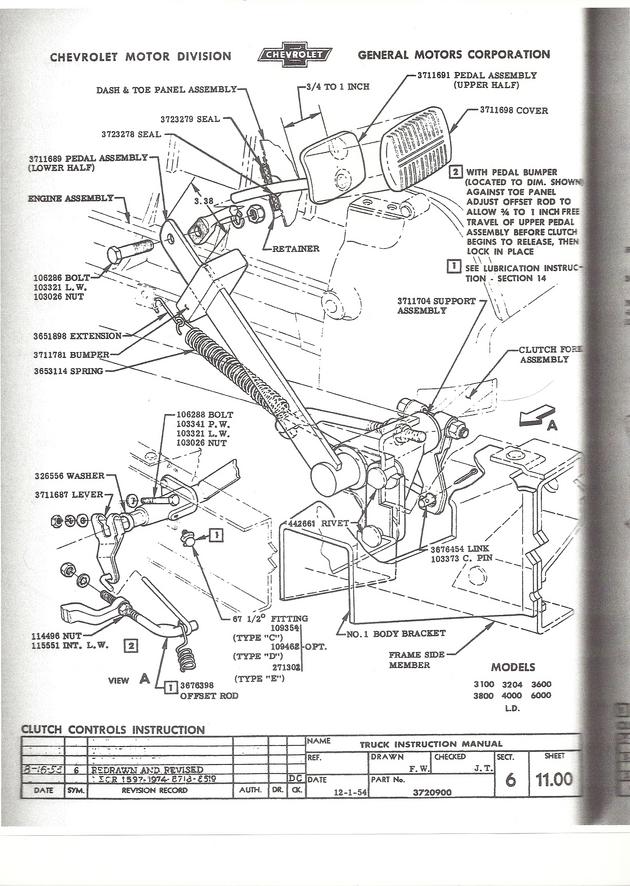

    The 55-59 chevy truck clutch pedal ***embly also does pretty much the same thing that you're making...but it's a clutch pedal, not a brake pedal.

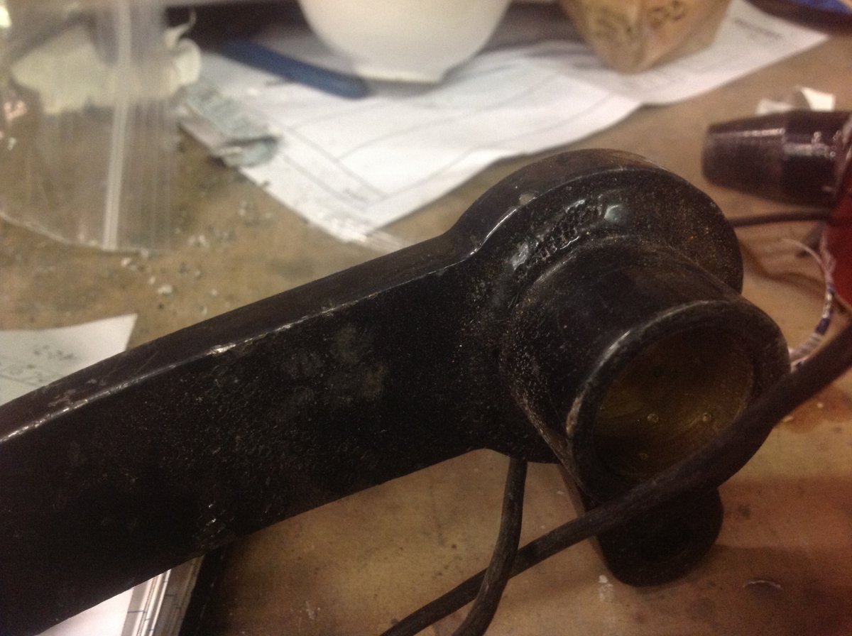

  11. Yes, that is pretty similar.
    I've seen quite a few clutch pedals hung on shafts that have splines or some type of DD end/flat spot stud and nut. But that's a clutch not a brake pedal.

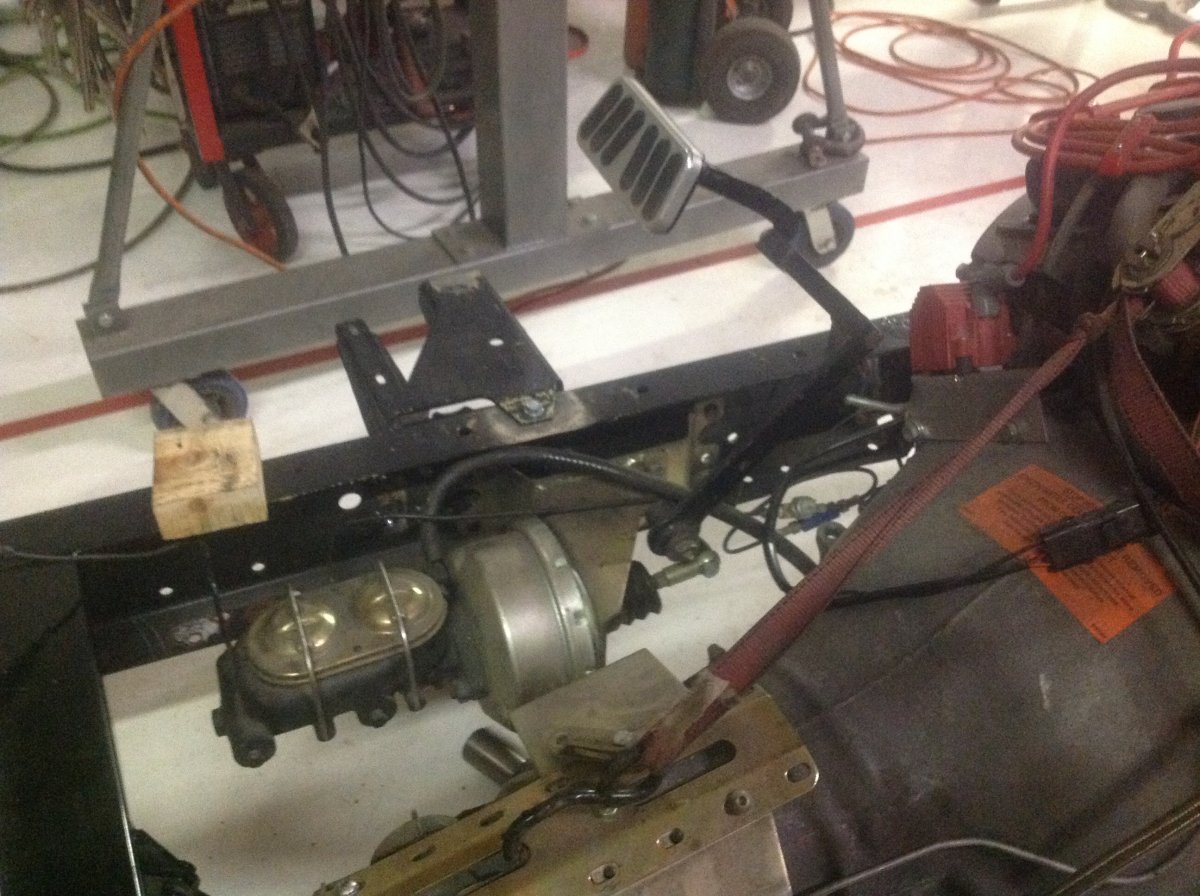

    Little back ground-
    Since the truck is finished , if I come up for the floor penetration in the same place, that is out side the frame all will be good. Moving the brake pedal to a better spot inside the frame is going to bother the steering column
    Moving the steering colum and poking holes in a finished truck really isn't a good option.
    Under dash is crammed full of **** and I'm not allowed to clutter up the firewall.

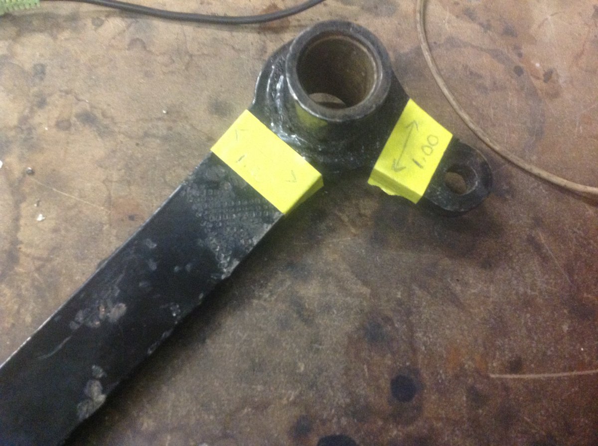

  13. I sorta figure whatever I do should be as strong as these the smaller of these 2 areas
    1.00 X 3/8" that's pretty strong,,,, but isn't the the smallest area around the small hole,,,
    That's 1/4" edge to hole in 3/8 plate. That area sees a different load

    First, your design is much like my '57 Chevy STOCK clutch pedal. A D-D pressed into the pedal arm and a splined end with a clamp holding the through firewall rod. I highlighted stock because the shaft diameter is 3/4 as is yours. I think the shaft is up to the task.
    My suggestion is to use two set screws on the splined end at 90* rotation of each other. You should ***emble the splined end before installing into the car and drill a small hole in the splined shaft at the location of the set screws. It only needs to be deep enough to go to the bottom of the spline. This will allow you to tighten the ***embly to prevent back off and allow future dis***embly. Some type of thread lock should also be used.
    For the opposite end I would not use a roll pin. Instead, you could tap a hole in the shaft end and use a washer/bolt to hold the "swing arm" in place. You could weld a D-D washer on the shaft as a stop for the back of the "swing arm".
