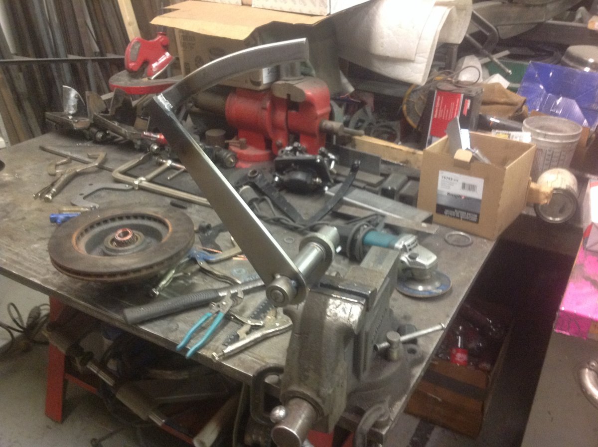

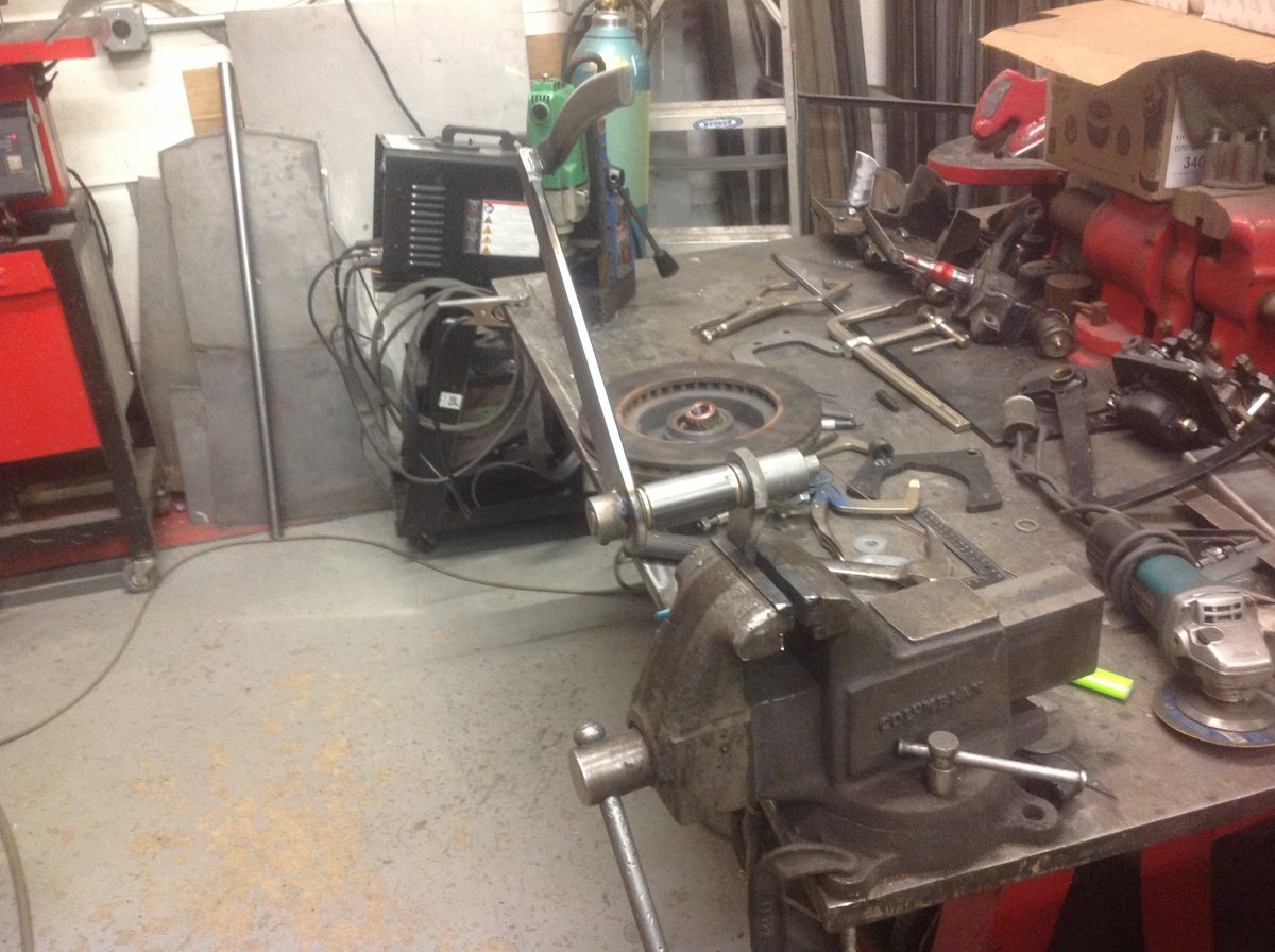

  13. Rough mock up.
    Tube length and shaft should get shorter after I start the figuring

    Bearings or bushing's splined or dd? I'm no engineer where math is concerned. 31Vicky and all those that have thrown out the numbers I envy all of you and I see where your all coming from. But here's what I take from all this. Is a panic stop going to have the same affect as a ball peen hammer striking a solid stationary piece of steel. The Wrecking Ball affect is how I'll describe it. Isn't there going to be same give that will decrease the load? Things like the drivers angle, flex at the pedal lever, absorption at the brakes pads and or shoes, flex brake lines expanding? Can math answer these visuals and make this re-engineering more comfortable to accept in regards to a good nights sleep?

    I believe the concern of a catastrophic instant failure would be pretty remote using the steering components. The effects of the pivot point bushing wear and the cross shaft work hardening and becoming weak at the bushing edges over time may be a different story. The advantage that exists is that there is pretty limited rotation involved.
    I wonder where they get the 200 lbs of pressure. I'm a pretty big guy, I can ***ure you, in a panic stop, I would put a whole lot more pressure on that brake pedal then 200 lbs. Way back in high school I could leg press 3.5x my body weight. Figure 1.75 my body weight for one leg, your at over 450 lbs of pressure, and that would be on the pedal. You would need to add in the numbers for the additional leverage of the pedal arm length. Maybe some destruction testing then stress crack inspections are in order here?
    I still think the steering components will hold up fine! Gene

    You can always do what we did in the spacecraft industry, build it and proof-load it. Build a stub frame with the tube and bushings, make your pedal ***embly, anchor the M/C end and apply a thousand or more pounds to the pedal and see what happens.

    The forces out of a typical clutch pedal are pretty constant; an example would be about 300 lbs, given a 50 lb input and 6:1 ratio. The linkage, clutch lever and release arm take up the remaining forces necessary for release, normally around a 10-11:1 overall ratio from pedal pad to T/O bearing.
    Brake pedal output forces could vary from under 100 lbs to well over 1200 lbs with that same common 6:1 ratio, depending on constantly varied pedal input.
