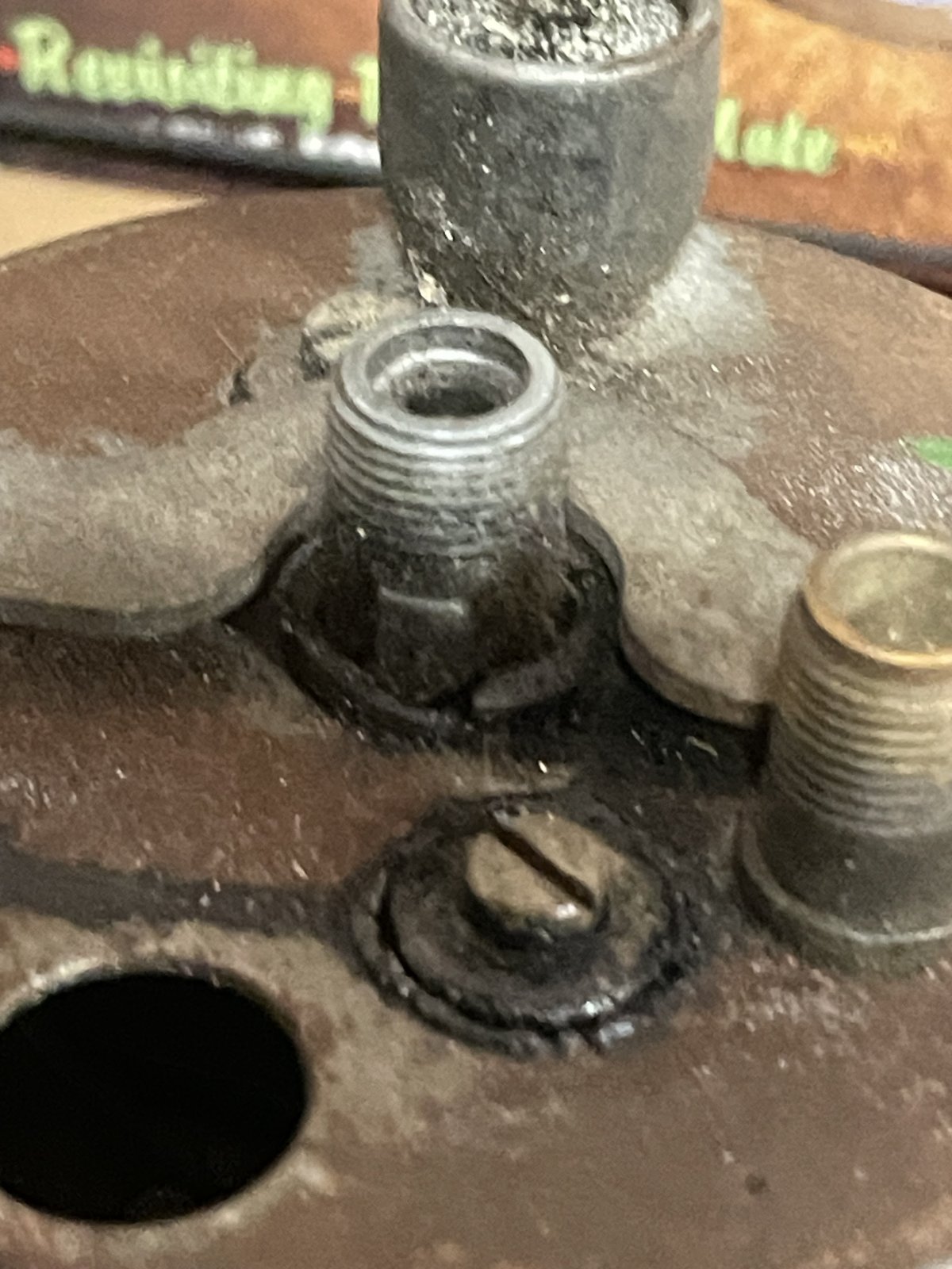

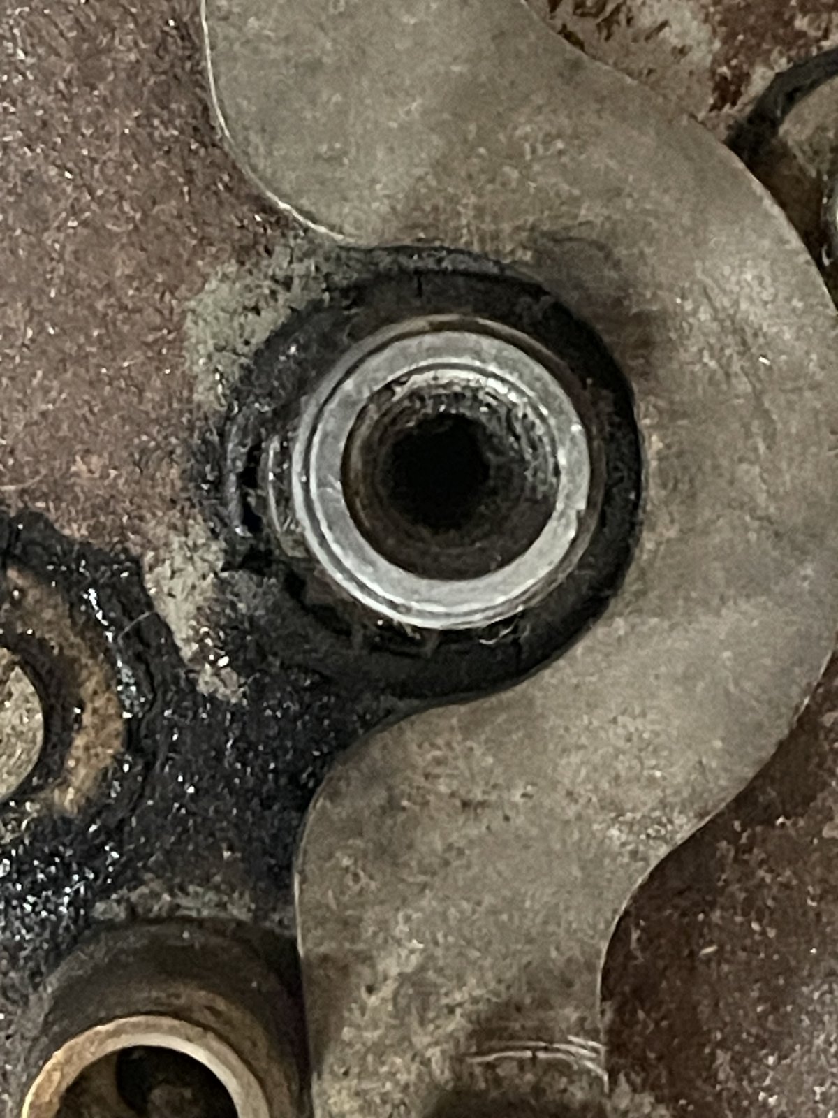

  9. Kiwi 4d
    Joined: Sep 16, 2006
    Posts: 3,865
    Kiwi 4d
    Trusty rusty to the rescue again. Thanks @ e1956v I will send you a PM . IMG_3936.jpeg IMG_3937.jpeg IMG_3938.jpeg
  10. e1956v
    Joined: Sep 29, 2009
    Posts: 2,574
    e1956v
    Alliance Vendor
    The other thing to keep in mind is that most US speedometers are 1000 cable revolutions per mile by the dial picture this speedometer is 1600 revolutions per mile.
    So a gear ratio adapter may be needed for calibration. That means a T5 Ford adapter for the transmission end of the cable( it has 7/8-18 threads on it for install of a speedometer gear ratio adapter) I have all of this in stock if needed.
    Just a heads up, I know New Zealand’s inspection for safety and speedometer calibration is strict from experience with New Zealand customers in the past. Was it you I helped with on the Cadillac speedometer calibration?

    Sheesh , many thanks Rusty @e1956v that was a pitfall I wasn’t aware of with the different revolutions. , as you can see from my speedo pic we are from down under. No Cadillac speedo here . Yep our inspections can be a PIA sometimes. Will PM you our requirements.
