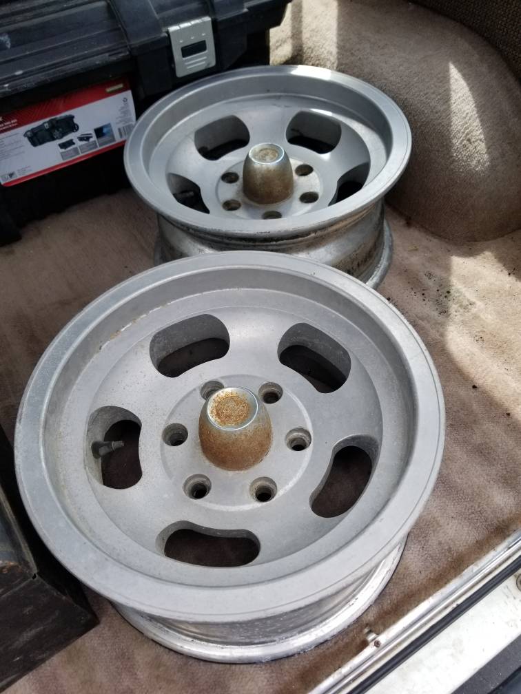

    I used my milling machine to open up the holes using a boring bar set on a boring head. The tool was expensive but worth every penny.
    Any half decent machine shop could knock this out in an hour or so.
