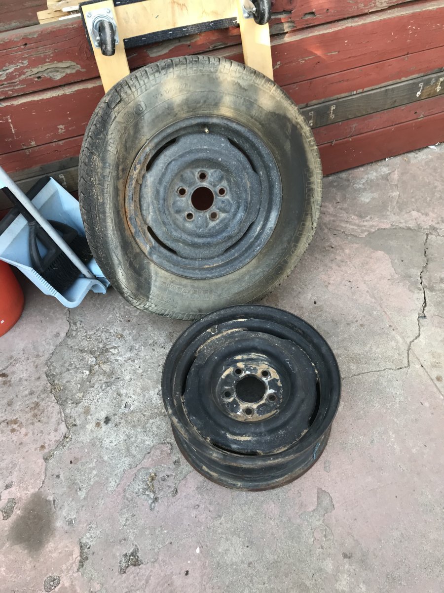

    Thanks for all input. I think I've found a set of 15's with the larger center hole that will take the poverty caps. They will be cheaper than either machining the axles or the wheels.
  4. He'd need the post-'69 versions with the larger center hole, but those should be pretty common.
  5. I did it with a large pipe reamer.
    Elcohaulic and thintin like this.
  6. see the lower wheel in this pic. It is the style for the larger hub, they made them in both 14" and 15"
    with some people, talking trash on peoples welding, then come over here and say "yeah just remove .16" in from the part of the wheel that holds the structure? Really SMH.
    you remove that little ring, its like taking the white ring off you red drinking cup, albeit not as bad, you will just spill some beer, but in a car that will get used and abused....well have fun.
    I mean someone just posted that they got stress cracks and all that, I recall seeing some do this to steel wheels years ago also. I also said I would not run those aluminum slots , Im sure they would not pass as inspection.
    Either get the correct part or don't bitch about later when you have a failure. and if you can't afford now, save your money and hit the junk yard- or ask friends, you end spending as much for that tool to cut the hole bigger. the rims exist. If you were closer I would throw that rim at you for free.

    So looking at the Al wheels, if the guy bought a set to fit, what would be the difference?

    No sure where you're going with this but after all things considered and not want to take a chance with cracks developing from enlarging the center hole or having to have the axles machined, as I said, I located a set of wheels with the correct center hole. Problem solved. Again, thanks for all the replies. I'm a long way from having the Ranch Wagon on the road so I know I'll be asking for more suggestions in the future.

    Cut the centers out of the wheels to whatever size you need. Machine them or cut them with a torch, or whatever method you have available. We cut the centers out of a lot of wheels (with a torch) we used on our dirt track car and never had an issue, and I suspect those wheels were under a lot more side load stress then your wheels will ever see.
    I've cut the centers out of a 1 ton truck and loaded the crap out of that truck for a lot of miles afterwards.
    I'll cut the wheel over cutting the axle hub any day, I'd be way more concerned about the brake drums centering on the hub then the wheels centering on the hub.
    If your concerned about the lug nuts not holding the wheel tight enough, maybe its time to replace the worn lug nuts. You don't want to know how many lug nuts I've removed to see the tapered angle is no longer a straight cut but have a worn curve where it used to be straight. People keep reusing the wore out lug nuts without even looking at them. Gene

    I had the same issue once hacking some steel rims onto a VW Rabbit, holes too small by a smidge. Turned out one of my hole saws had just the right OD, and it fit in the chamfer on the back of the wheels, didn't even need a pilot. Spun it slow with a 1/2" hand drill, done in a few minutes.

  18. There is very little meat left inside the bolt circle. Those will probably crack from the lug holes to the center register. Remember, steel and aluminum wheels perform differently. There is a reason SCTA has differing rules for both types of wheels.

    The aluminum slot mags I bored out have the same bolt circle and hole size as ones made to fit my application. Same brand wheels, etc. Mine just happened to come with the smaller diameter hole which I machined out.

  23. I had some that were cut out with a torch to fit, really shaky, I welded a 1/4 in steel ring made from rod to reinforce the wheels, worked ok. I think some pickup truck wheels have a bigger center hole.
