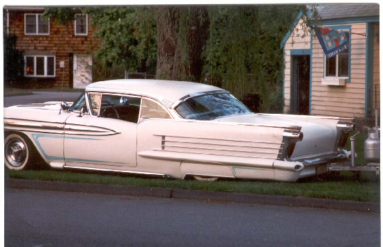

    Here are a few pics of what I worked on last week before the drags. Right now the weather in IL is PERFECT for working in the garage at night. Nice and cool. So my welder has been fired up now for over a week, except for my little trip to the holyland. Anyone that saw me over the weekend could probably tell who I was by how much my face was peeling from my Tack-a-thon last week. No it wasn't a skin condition, so choprods it was OK to make out with me, I am not contagious!
    Anyway, there was some stainless trim that ran down the length of the Olds quarter. Since I cut a COCKpit out of the decklid area I needed to shorten the trim and thus change the stamped in body line that the trim attaches to.
    So first I cut the trim down to the proper length. That was easy, it was stainless, so I just wrapped some tape around it and lopped it off and polished the ends up a bit.
    I put the trim on the body line and cut everything off around it until it fir down on there and I marked the "point" on the end where it was going to end.

    I made a cardboard template of the little filler piece I needed to fill in where the body line was removed to the COCKpit. I trimmed out a chunk and stuck it in there with my handy dandy harbor freight panel clamps. I needed to fill in the center of the point with something I could grind a shape into so I took some 3/8 rod scrap that I had and welded it in there and trimmed the sides to fit.

    A little more grinding and a little more welding and here is what the finished product looks like. I still need to grind down the welds on the flat part but I was running low on ROLOC's so I will save that for another day.
    The whole ordeal took about 2 hours. Then I repeated on the other side.

    all that work for nuthin!! around here i just buy my quarter panels by the gallon......that looks fuckin awesome.. ivehad this car for 20 years maybe ill cut it up for a roadster its a 58 olds
