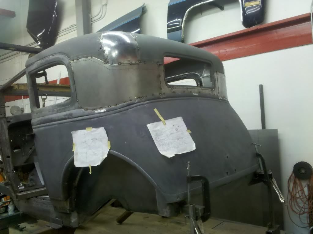

    Door width is the same, 4dr doors are a bit taller in the window than the coupe doors, the rear quarter window radii are the same/extremely close, just a larger dimensions all around so they will be identical to the coupe ones once the smoke clears... the panel between the rear window and decklid is completely different and will need mucho cutting/welding/grinding to work... probably the BIGGEST obstacle is the rear roof has WAY more crown than the coupe roof.... lots of "adjustment" to take place there. I'm not too worried about height/crown right now, I'll tackle that when chop time comes... just cut until it flows and looks right. Was really hoping to be able to use the coupe rear roof... Oh well, it'll make for a better story when it's all done, right?

    Joined: Mar 6, 2008

  4. wheels777
    Joined: Oct 29, 2008

    wheels777

    Really enjoying the build.
