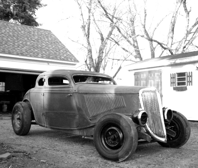

  1. Wow. ****in' perfect. How much would you say you ended up taking out?
  2. thunderbirdesq
    Joined: Feb 15, 2006
    Posts: 7,091
    thunderbirdesq
    Hard to answer exactly... with the 4dr b pillars being taller, I took about 6.5" out there, 5.5" out back and then just lowered the front down and trimmed the A pillars till it looked right. Your chop looks pretty close to this one, wouldn't you say?

  10. JeffreyJames
    Joined: Jun 13, 2007
    Posts: 16,626
    JeffreyJames
    from SUGAR CITY
    SO very awesome......but I'd like to give you a refund if you'd like to return it now please.....:D
    Would you hate me if I said that I feel like those healights need to come back 6-8 so they're not out in front of the grille so much??? Probably running into something like a shock mount huh?

  11. chopt top kid
    Joined: Oct 13, 2009
    Posts: 959
    chopt top kid
    Those headlights are dead nuts!!!:D

  13. JeffreyJames
    Posts: 16,626
    JeffreyJames
    from SUGAR CITY
    Are dead nuts now after I photoshopped them or they were in the original pic on the previous page?

    Thanks again guys, it's been a wild ride so far! Jeff I'm gonna have to p*** on the refund man, I got about 20k in sweat equity in this pos, hahaha! Like Kiwi Kev says, it's an unGODly ammount of work and I still have soooo much to do!
    Jeff if I bring the headlights back any further the front edge of the hoodside smacks into them every time you open or close the hood and the front hood handle is hard to operate... at least at the height/width they're at. I actually brought them forward some to avoid that. It's still tight. I'm still playing around with them a bit and toying with the idea of a front tie bar for the mounts... I'm trying hard to concentrate on the critical **** to get it on the road at this point now that the body is almost done.
    I attached the rear quarters to the subrails yesterday and got in the car and pushed things around with the portapower ( a jack and a 2x4 and a big long pry bar) until everything was pretty even. Looks like all my rear measurements are within 3/16" which is plenty close enough for me. There is still a bulge or two in various areas of the rear quarters that I'll have to try some heat shrinking and a little hammer/dolly work on but, man... I just sat out in the yard with a beer staring at the thing for an hour last night.
    Can't wait to hear this sonofa***** bark!!! I'll post some video if/when I get it running.
    thanks again to everyone who took the time to comment on my progress here, I get a kick out of you guys getting a kick, haha! and DOUBLE thanks to the guys who helped me out with parts and advice so far, especially Kiwi Kev for his detailed chop thread, what a great reference...

    Makes total sense. I forgot about the hood swinging up. And if you went wider then the tire probably would catch them. Form Follow function there I guess. Looks great!!!
