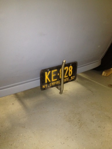

    rear frame horns and spreader bar action tonight... think I'm gonna add a lil' pushbar too, but I'm gonna wait until the license plate is on there and see what it looks like.

    I dig the exposed spreader bar!

  20. ImageUploadedByTJJ1333544915.443023.jpg I made my push bar the license plate bracket ,or is it the license plate bracket the push bar? Now I'm all confused, I gotta go sniff some more paint fumes.
