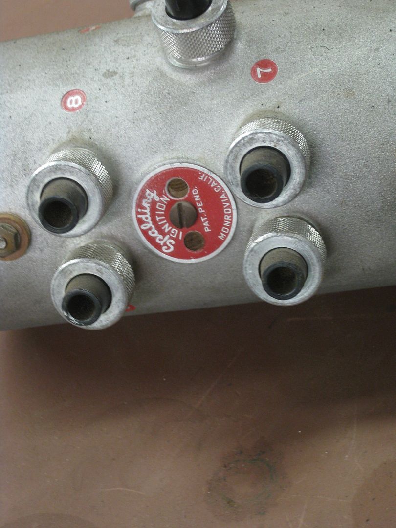

    ah man... I love Y blocks too! boi-oi-oi-oing! How cool is THAT sparker!? tach drive... way cool. I just got a Mallory DP with a brown cap for this engine today.

    And last but not least, these both came into my posession today!
